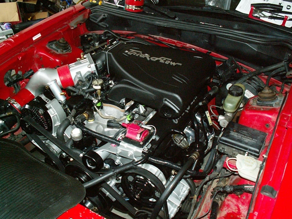

I painted mine! ..............................................
Black. :lol: Didn't notice the car running any hotter than usual. :shrug:
I will say I now have a black powder coated Trickflow setup. And the SILVER painted C&L pipe before my T/B gets hotter than my upper intake. :o We checked this with an infared thermometer.
