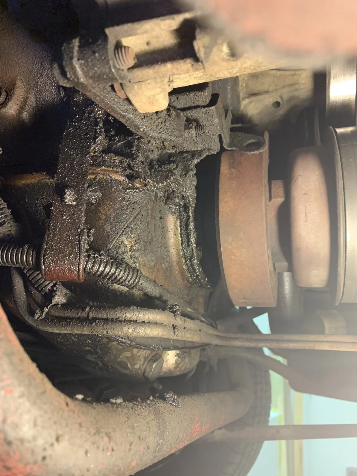

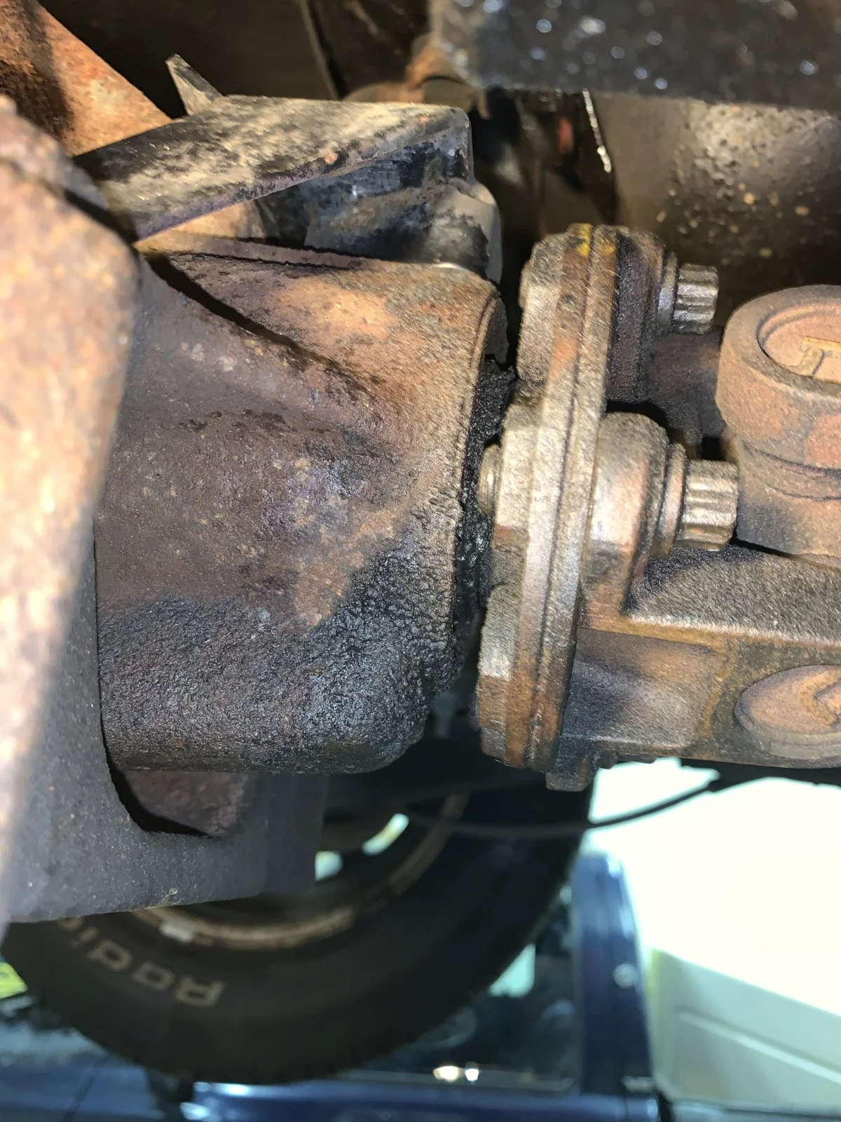

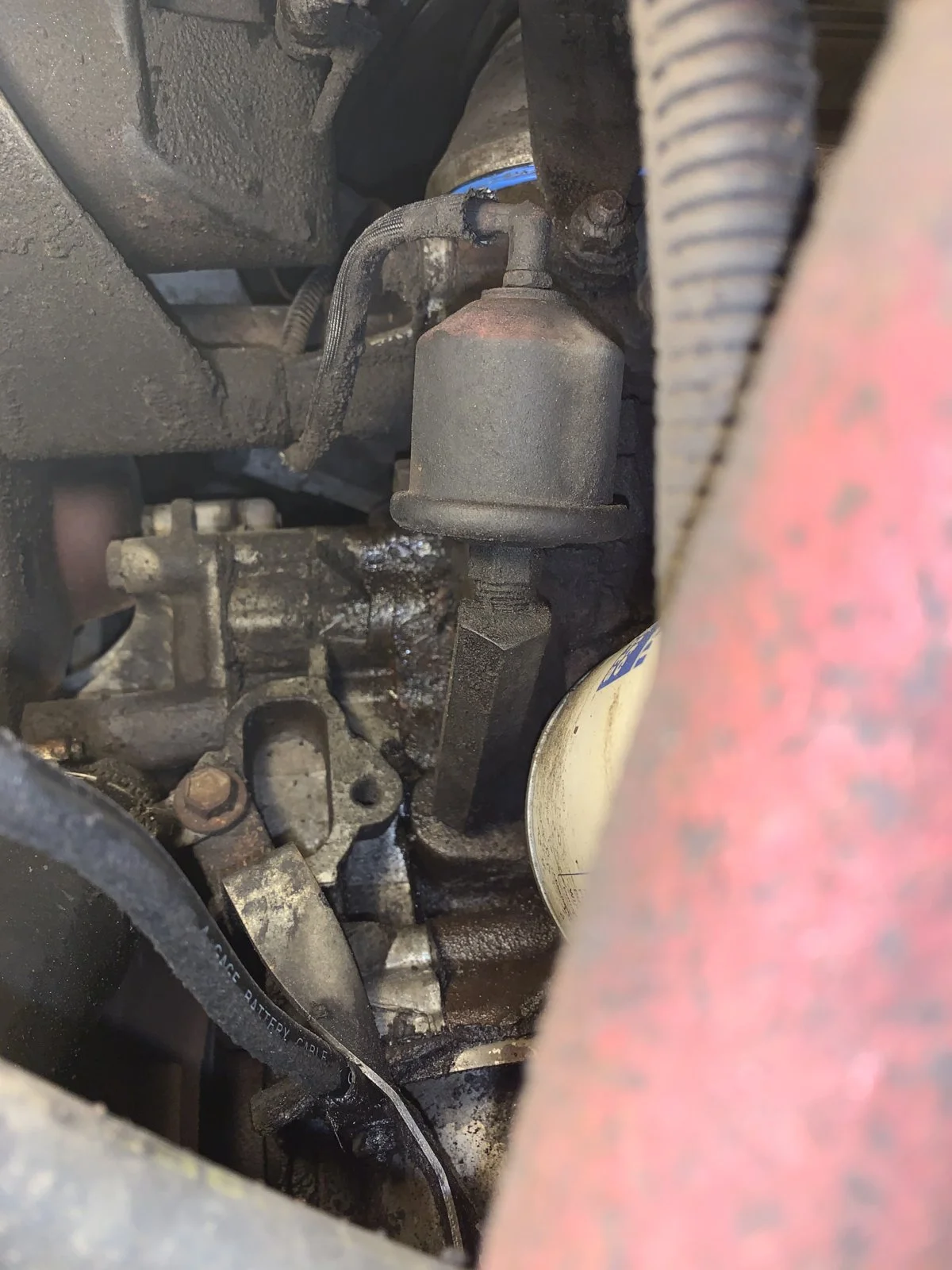

I have a 86 Foxbody LX 5.0 w/ 302. I lifted it up yesterday to check an oil drip leak and noticed how wet the oil pan was around the gasket, what would the process be to change the gasket as well as what other things should be changed/checked in the process? Also, the rear diff is leaking toward the axel insertion would that be a gasket as well?

Oh man, there's so much grime in there it's hard to tell the source from those pics. Since there's a ton of grime up above the gasket as well it could be the valve covers, or maybe a bad front main seal that has blown crap back all over from the fan, or timing cover... really anywhere. Clean the whole area up and see what gets nasty first.
As for the rear end, that looks like the pinion flange seal, not one that's simple to replace without the proper tools/procedure or you'll risk ruining the gears if you don't set the preload properly.

OK, I'll check the front main seal as well as the timing cover, it is not the valve covers as the gaskets have been replaced. Since I might have to potentially change the pinion flang I'm thinking of changing the rear gears as well any recommendations 3.55 vs. 3.73?
