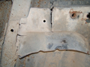

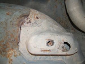

Well I started hearing a popping sound as my suspension got worked from side to side and lookie what I found today :shock: it would seem that the points on my frame where the gas tank straps bolt down and my panhard bar also mounted are now destroyed Lol. Not to worried about fixing it up just a little fab work and welding but my question to you all is, on just a strictly street vehicle (will see maybe a 5 psi bolt-on supercharger kit MAX) is a Panhard bar worth having? The kid I bought the car from had already put it on so I didn't mess with it any but as you can tell from the pics I should have checked things out :bang:
**The 2 pics are the spots that the gas tank straps bolt down to, the panhard bar piggybacks the straps and the same bolt holds the panhard mount and strap.

This one does, apparently they shouldn't :)

It has been looked over fairly well, main reason I didn't see this is because I never dropped the gas tank, but I put a whole new front end on it from the shock towers forward the rear was gonna be this winters project :) oh well, it was a salvage title and I got it cheap with ALOT of bolt-ons so no biggie I'll get it welded up and continue the abuse, just need to decide if that panhard bar is going back on or not.

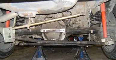

Thanks Vr think I'll just reinforce the mounting points when I fix em up and keep it in. Obviously its taking some sort of movement out or it wouldn't have loaded up enough to tear sheet metal like that. And to answer the pivot question a bracket hangs down on the left of the bar I was holding up in the picture (which was the frame brace) that the brace and panhard bar itself attach to and pivot off of .. the panhard has a hyme joint that mounts on the right side. I'd go take pics but it's late :)

**Ok finally got some pics of how its supposed to be set up .. as you can see the right part of the frame brace is just kinda hangin in the air because I just got done drillin spot welds and hackin that broke piece of frame out to fix/reinforce it

Well you asked the question"is it worth it" Yes a panhard bar is definiltey worth it. Is the one you have worth using? Definitely NOT. as others have stated throw it away and get one from MAximum Motorsports or a Grigs Watt link. The one you have will just tear out again. I have a Max Motorsports panhard bar and it works great. Chassis brace bolted and welded to the frame rails and all pivots and mount points are on the chassis brace not tied to the sheet metal.
