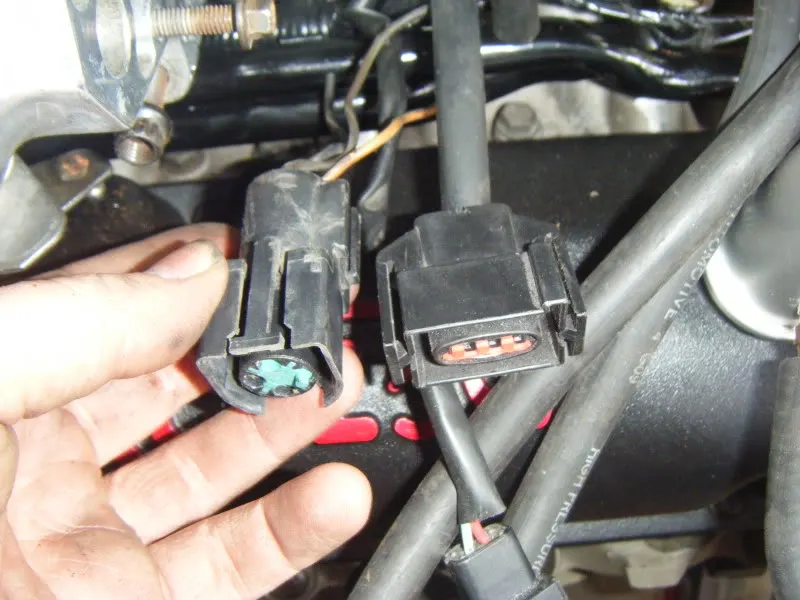

Jimmy...I did it...its a direct swap. Hell i used a cable from my old lincoln mark 7. Its alot cleaner for when you delete the EGR. BTW i have trickflow pushrods that i used on my 302 with trickflow heads and the same rockers that will probably work. They're 6.700 .080 I'm in your area and have done all kinds of this stuff before. fox throttlebodys are cheap and easy to come by. The only difference is the wiring on the Throttle position sensor or IAC (cant remember which one) I also have a Holley (Walboro) 255 pump sitting here too. I even have a 75mm trickflow r upper....

the tps is the difference and you need the pigtail
