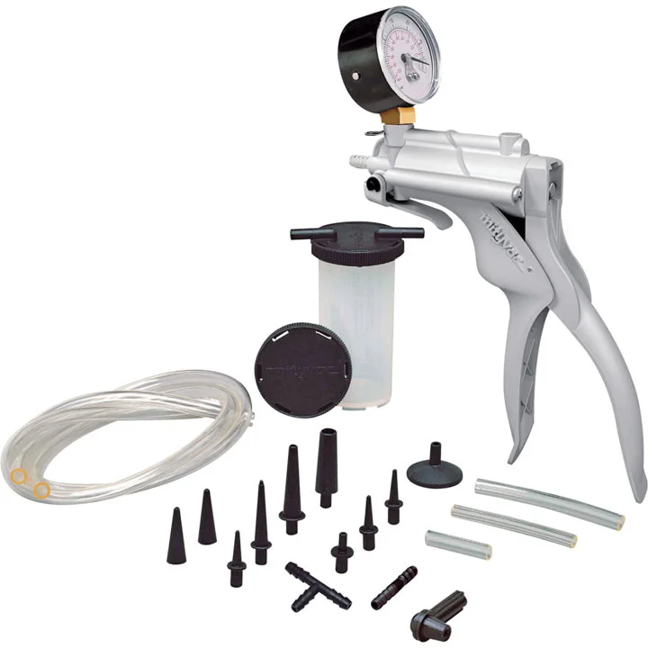

Look into getting something like this:
It doesn't have to be this fancy. Anything that you can use to force fluid back through that tube.
Lay a fluid proof mat down on your floor. Pump pure bleach back up that tube and let it sit for a couple hours.
Drain it and root it once more.
