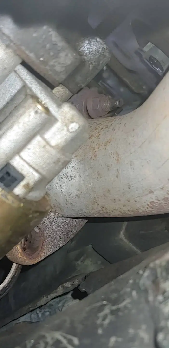

The bottom stud and nut are missing on my passenger side exhaust creating a bad exhaust leak. Where would I be able to find new studs and nuts for it? Or even a bolt that will thread into the manifold.
If the stud is completely missing and there is a hole straight through just put a bolt through it with a nut on the other side. If part of the stud is still in there you can drill through and do the bolt and nut. It will be a pain to drill so be ready for that.
