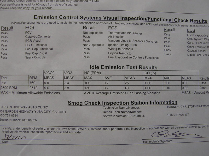

I am certain that a well tuned and maintained Mustang will pass anywhere. 5.0 Mustangs are actually extremely clean cars despite what the stereotype might suggest. Not sure what the limits are in California, but my car does (actual/limit):
HC: 24/117
CO%: 0.00/0.65
NOx: 154/821
CO+CO2: 11.7/6.0(min)
That's all at 25mph. The 15mph is virtually identical. What are the limits in California?
