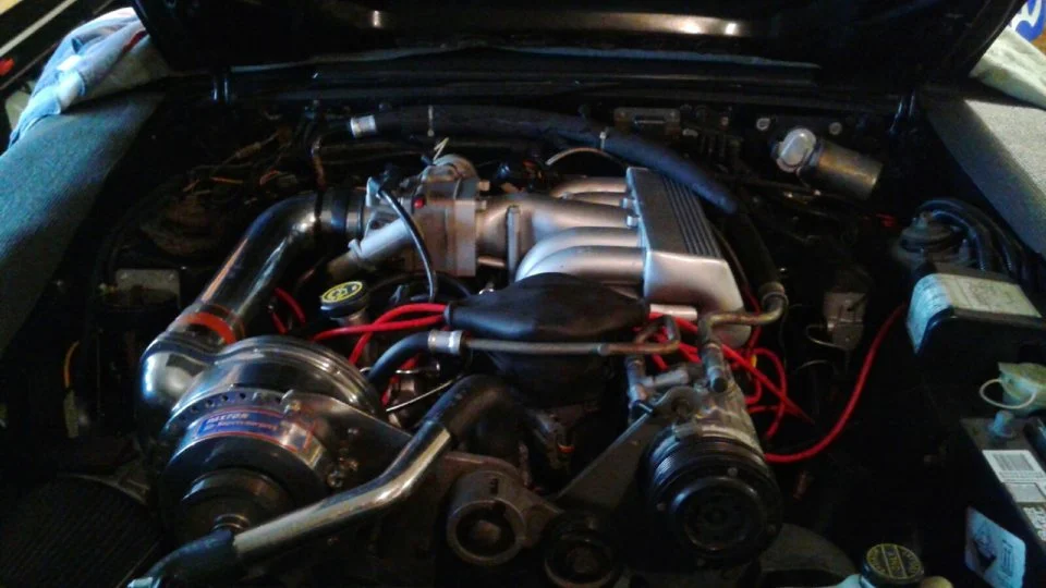

Hey, guys it been a while.. I'm putting a Paxton supercharger on my 86GT. I know its a old school set up, but I like old school. it matches the era of the car. I've got a good idea on a tune set up , but if any one has any pointers I'm open. I've got 24lbs injectors, 190l in tank pump stock rails and lines. fuel FMU with a 24lb disk in it,(the FMU is the only thing I don't know about.... timing s set at 10degrees. fuel presser is 42 with line off. I have a one step colder plug in it. it is a 306 ci , dart head , 10:1 compression , long tube header, GT/40 upper and lower. 70mm pro m , crane cam 544/544 288/288. blower makes 6-8 psi. anything will help thanks guys.
That's a lot of compression to play games with a 190lph pump 24s and a fmu . Personally that car needs 42s a 340 in tank pump , ditch the fmu and a real tune ESP with all that compression . And maybe a meth kit to keep the detonation down . @84Ttop what say you ?
I have an old school Paxton on my wifes 91 z28 350 TPI car had paradise wheels go over the blower and he upgraded the impeller for a few PSI more...what i would do is get yourself an Air fuel gauge and see where your at in Boost you might be rich or Lean that way you can play around with the FMU discs...or down the road get yourself a tune where they can get rid of the FMU totally....
I don't like the FMU set up. I have a auto meter air fuel gauge in the car in podded with my fuel presser gauge. Funny I just got it back from paradise wheels. He went through the whole thing , I'm putting a oil cooler on it is my next step after the track run on Friday. it feels good on the street. thanks for the info.
