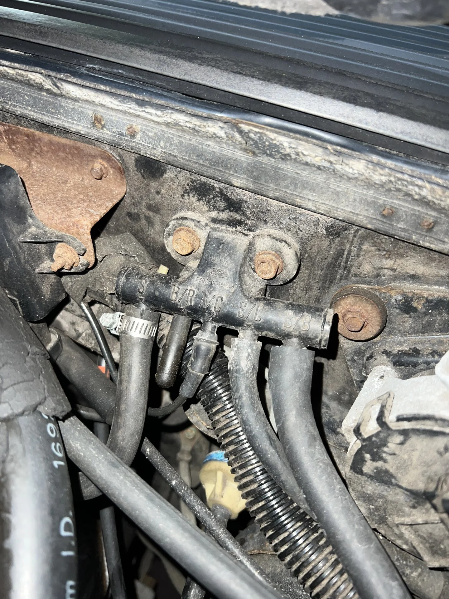

Just noticed this is plugged too, any idea what this is?

That’s the vacuum distribution tee (or tree). The one that’s capped off is normal.

Yeah nothing abnormal there

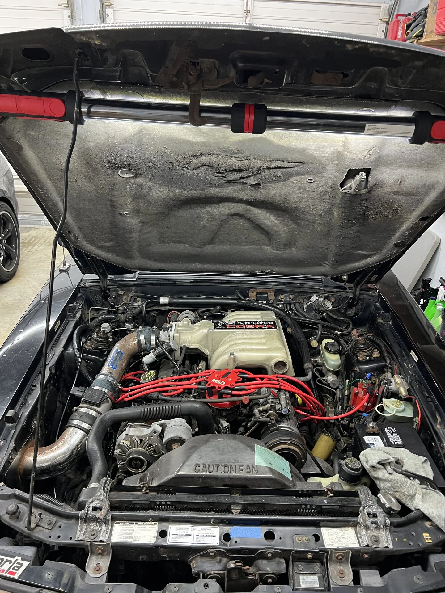

Oh ok nice thanks guys. Just wiped down the engine bay check it out
