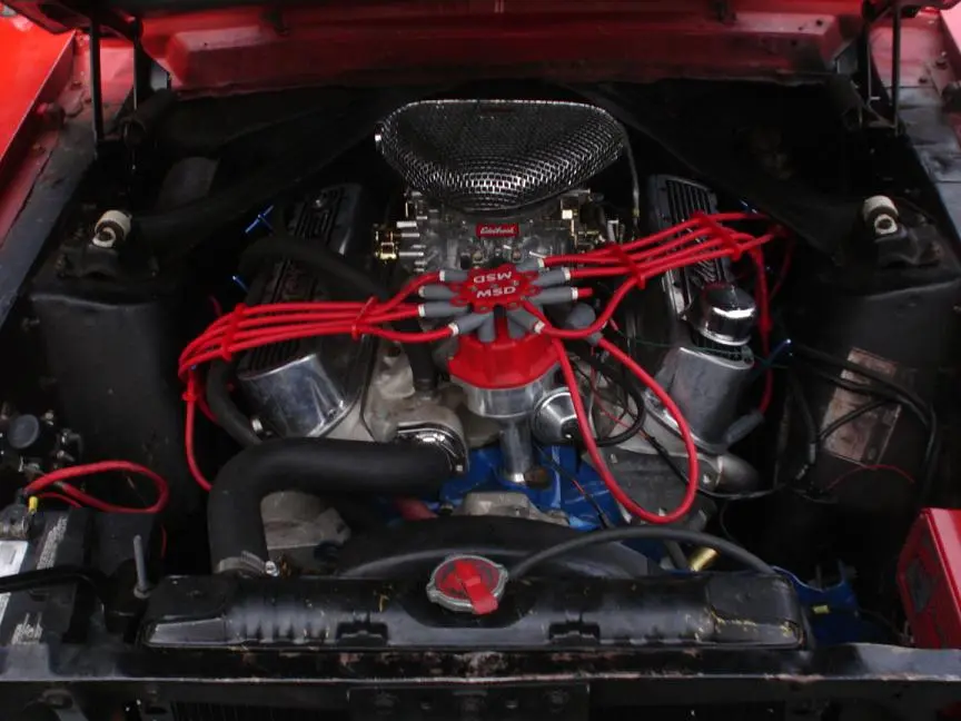

408 eagle fordged steel crank,H-Beam rods,JE inverted dome pistons,10.1 comp,performer rpm intake-cam-heads 2.02-1.60, edelbrock 750 carb,msd 6al+distributor,performance automatics comp c-4,3000 stall tci,9" rear.
Here is a pic of the motor.
