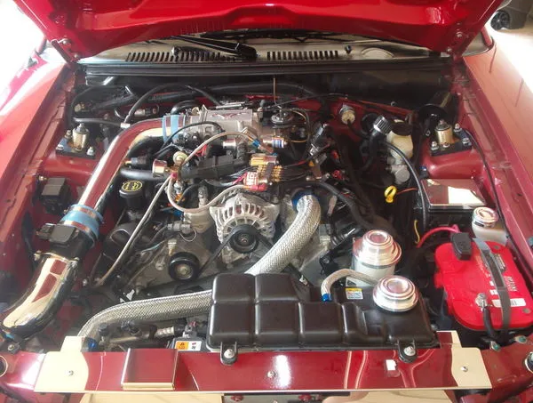

No it doesn't, at least it did not on my 02'. I had to pull the cam cover off to take it out. It had a metal clip that holds it to the cover from the inside. I put a plastic plug in it's place, a breather filter on the fill cap and another filter on the driver side cam cover. ...:nice: I don't have the oil fill cap breather in place in the photo but I have the one on the drivers side cam cover installed (next to the clutch cable and brake reservoir).
