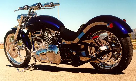

Ok, so back to the highlights.
attachment.php
That is the look I want to acheive. I thought that where the highlights are, where the light bounces straight off the surface and into your eye, is where you would see deepest into the paint, and so see the base colour best.
Is it the other way around? The above pic is a candy apparently. So would that be black/clear over blue or blue/clear over black?
EDIT: bsedwebt I know you answered this one, but is the above pic what it would look like?

I'd say that bike has something like a blue candy sprayed over a black base. This wouldn't be nearly as hard as trying to get a lighter candy blue. I'd take a look at House of Kolor's stuff, since they advertise their product towards the do-it-yourselfer and I've found their paint extremely easy to spray and get great results on my practice panel. In fact, it wouldn't be too far aff to say that if you can read and follow directions, and you can spray primer without runs, you can use their stuff succesfully. That's the beauty of a base/clear system, with the color (and pearls or candys) all you need to worry about is even coverage. The clear makes it shine, and colorsanding and buffing can help with the mistakes you may make there.

as to the chopper, i guarantee that you can match that paint with a regular base/clear paint. if you want the dupont number, i can give it to you.

So you're saying that the bike's colour could be done with just a base with a clear over it? Or would it be a tinted clear? In other words, can a base give the black-with-blue-highlights look?
Route666 said:
Rick, thanks for your input, I'm understanding it all now!
yes; or a color close enough to satisfy you. a base can give you the highlights
