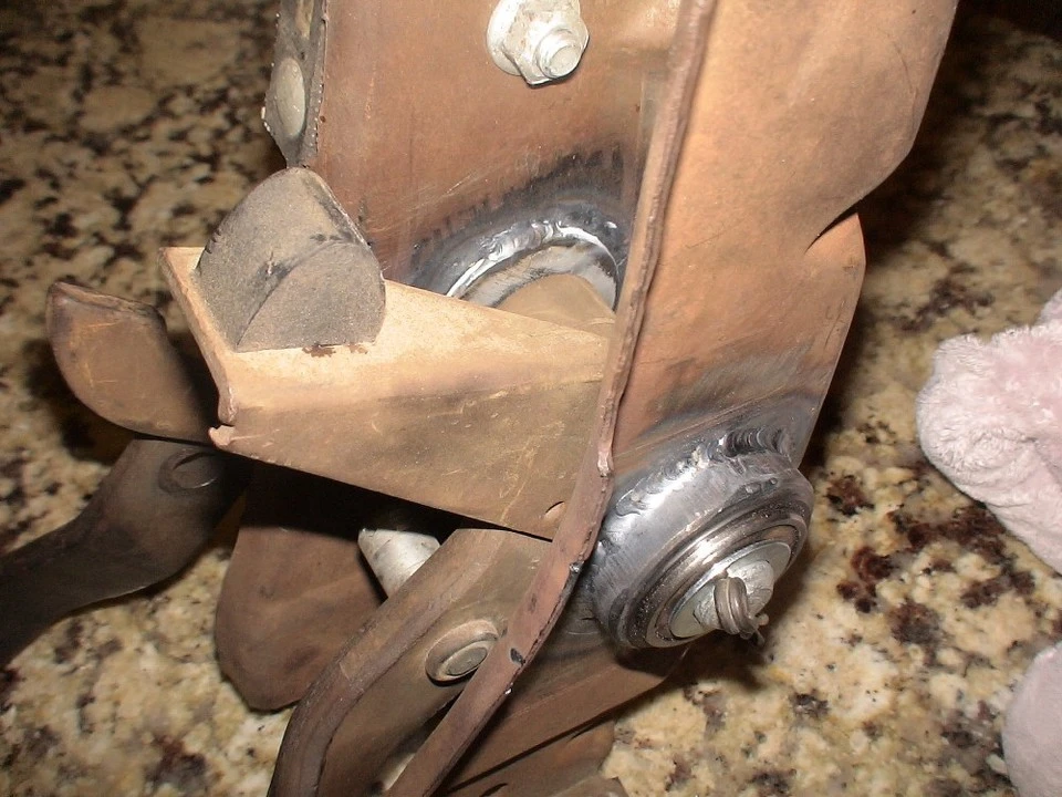

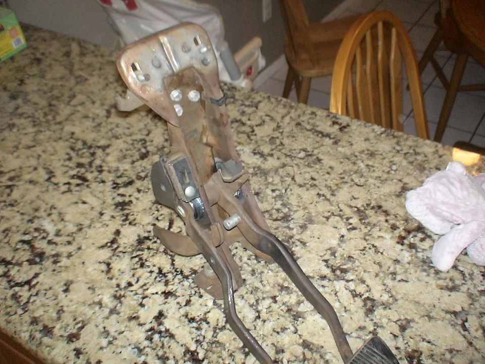

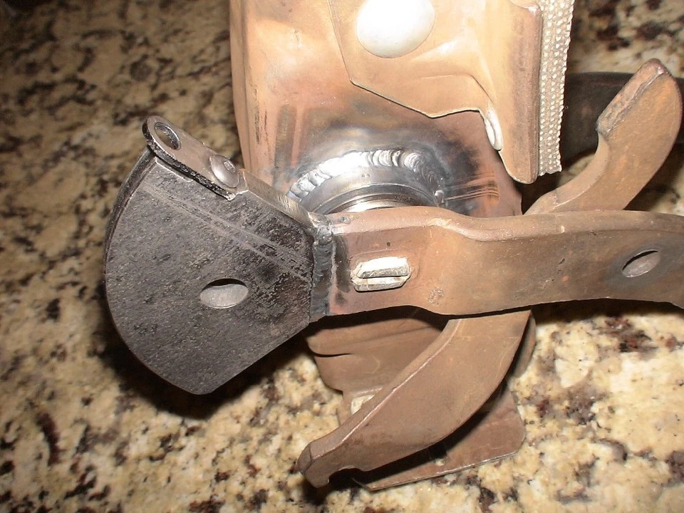

If you can weld, you can get the Mustang Steve kit and do it yourself. Here is a write up from when I did it:
Ball Bearing Clutch Pedal Support - FordMuscle.com Forums
