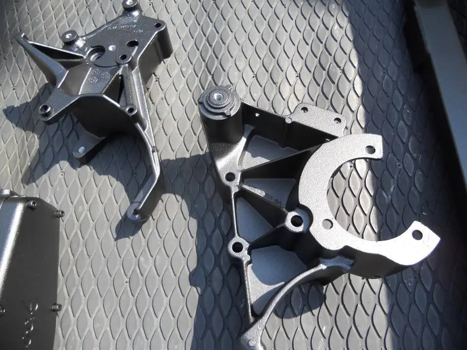

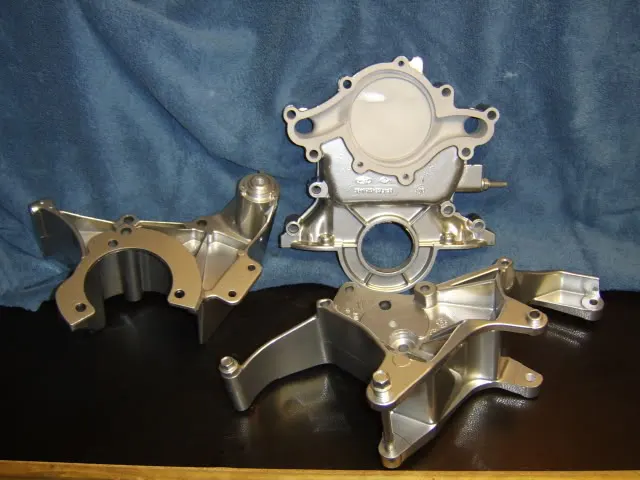

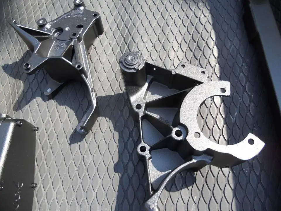

You can powder coat the accessory brackets and that looks pretty good. Also if you do so you have to be sure to sand off the powder coat on the alt bracket where the alt connects to the bracket. If you dont do this it wont start, or so Ive been told so I sanded off the powder coat on mine in that area. Some alt's come coated.
http://www.summitracing.com/parts/TFF-7771B6G/
*These are not powder coated*
I am also putting on that alt that I linked from Summit

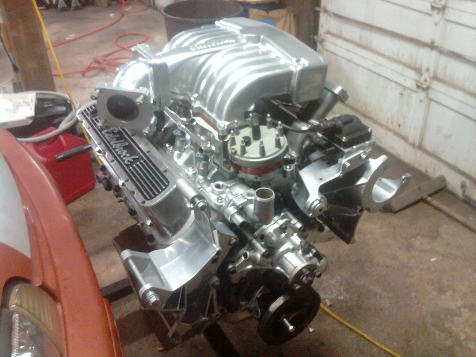

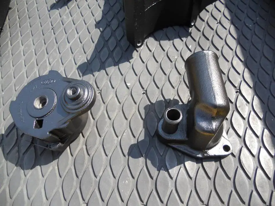

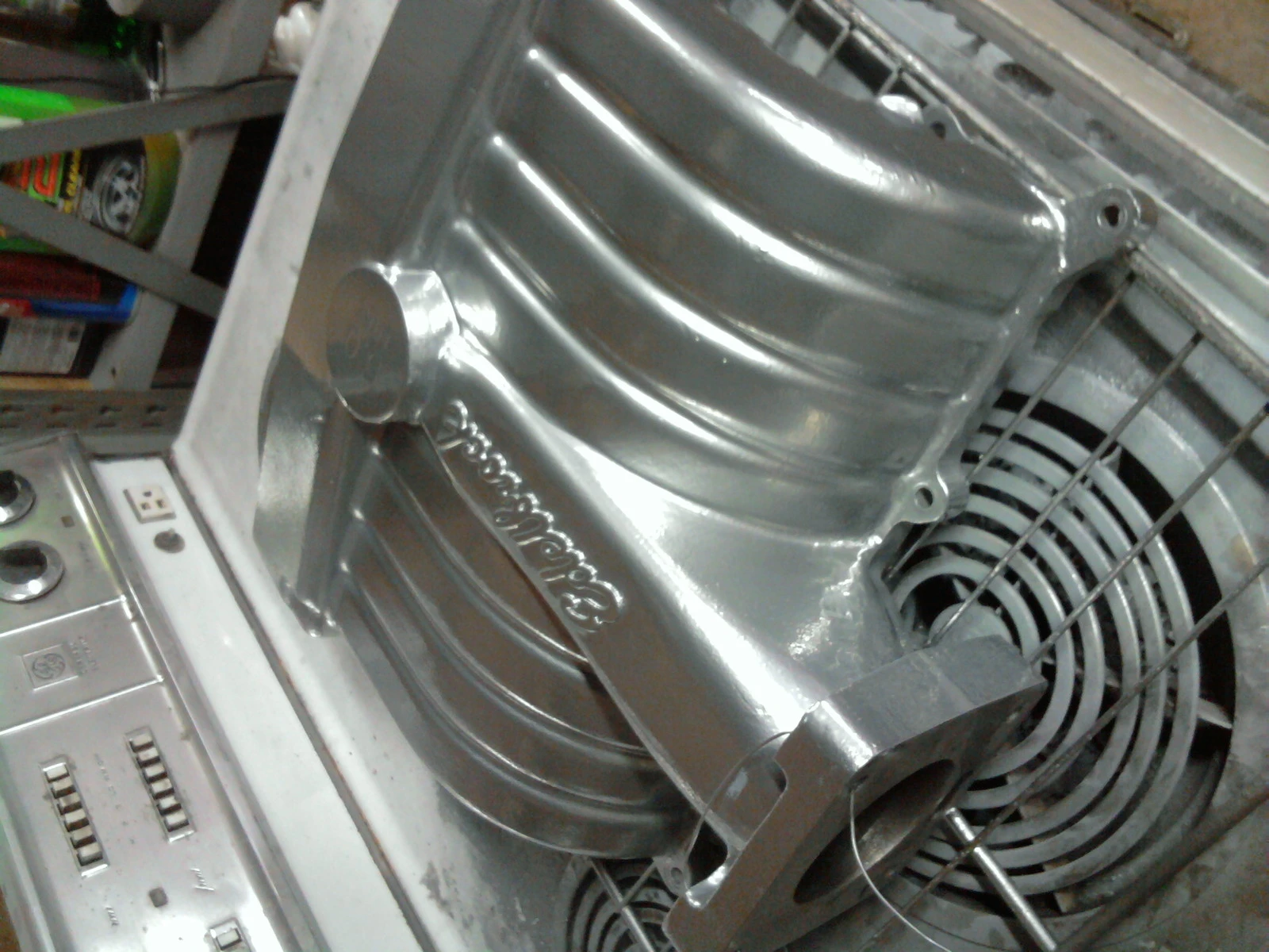

The water pump i would just paint. As for the alternator i powder coated mine chrome and have no problems with it so far but have only put about 2500 miles on it since rebuild. As for how much it costs well that really varies! Powder coating has become really popular over the last several years and there are alot of people that are doing it in the own garages now. So i would say try to find somebody that does it at there home because most professional places wont do anything unless they have enough to fill there ovens. I charge about $30 for a set of valve covers and that's cleaned and blasted as well. The more i do the cheaper it gets and all i have is an eastwood kit and an oven i bought off craigslist for $20. My water pump is painted it just matches really well.

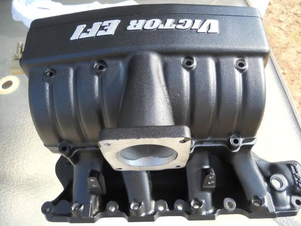

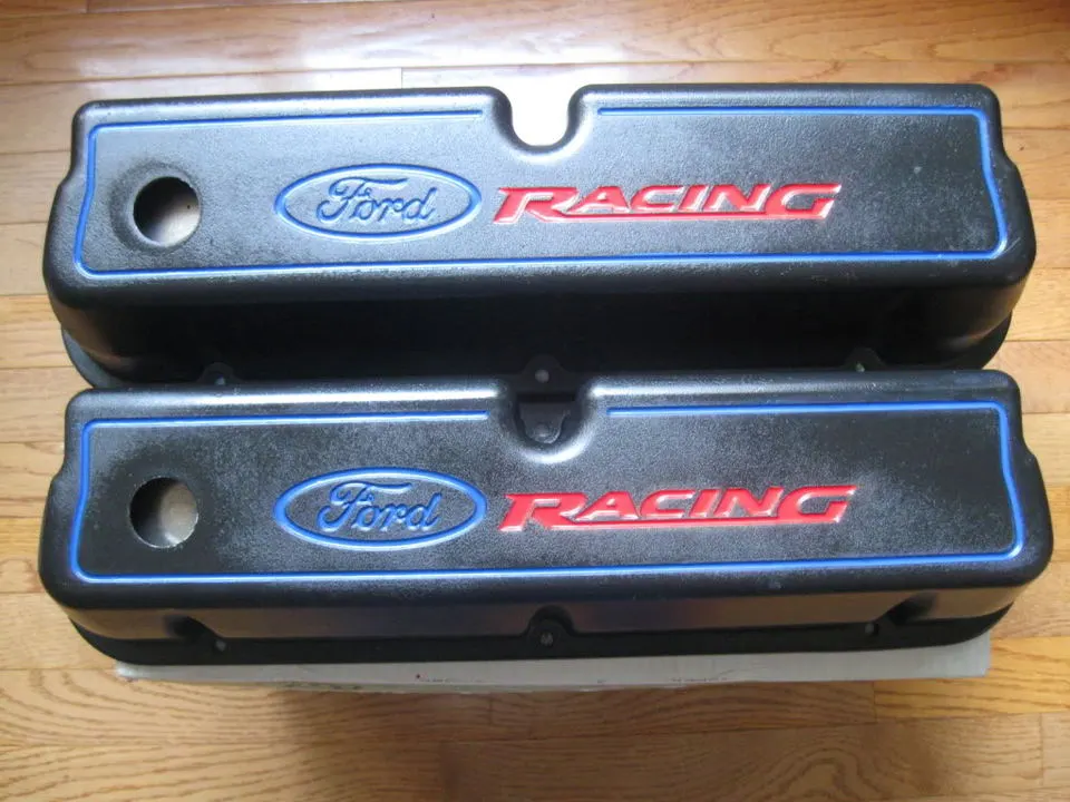

I would like valve covers, Upper and lower Intake and my brackets done.

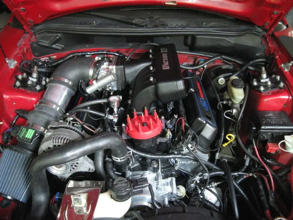

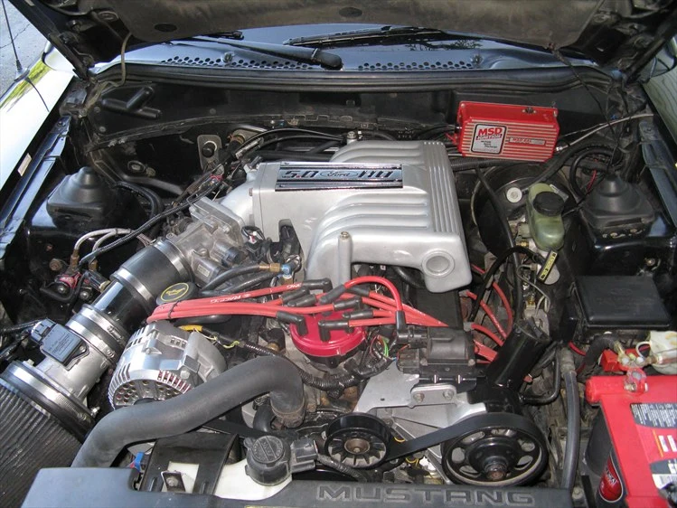

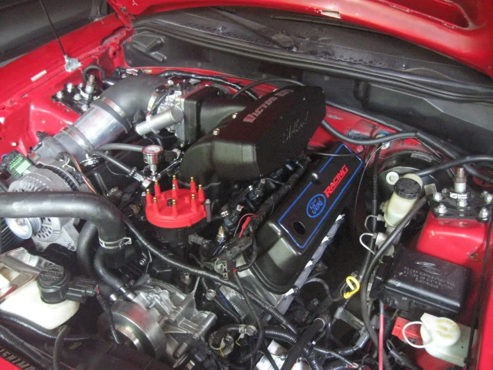

I had my brackets coated silver along with my explorer upper intake. I also had my alt. powder coated chrome. This was about 4yrs ago or so now. Not an issue with the coatings or parts. I drove it round trip to visit a bud about 2hrs away in July, drove it on the odd nice day, and for about the last month every day as the DD/beater is down.
I did have a major charging issue at first. I did not have clean/good ground from the alt and it was not charging the batt. The Alt. grounds via the brackets to the block, at first I ran a 8ga wire from one of the alt body bolts (there are 3 of them) to the strut tower to test if it grounded externally. That ground wire worked and everything charged fine. Then I removed the brackets and alt. and sanded the contact points where they touch the block and alt. I then removed the wire I had ran to allow charging and everything has been gravy for 4 or so years since.
