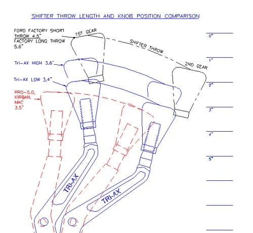

Someone created this, I found it quite useful for those contemplating which one to get and their actual throw
Scott
