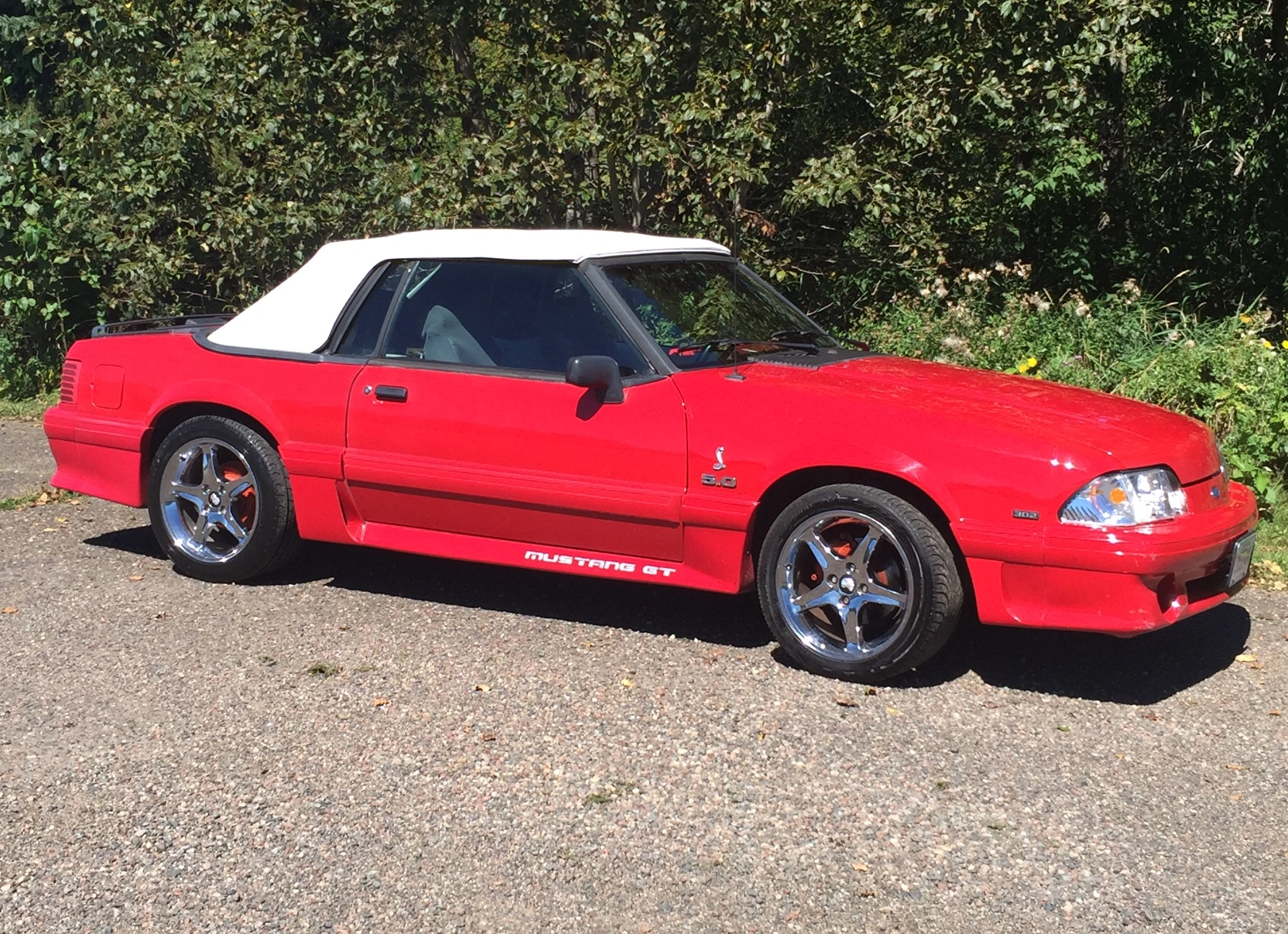

Hey guys, new to the forum here and just had a question or 2 about some performance add ons and exhaust.
I just bought a 92 5.0 GT convertible which is basically stock besides a K&N air filter and flowmaster exhaust. Now my questions are what are some relatively not so expensive performance add ons I can get to boost to horsepower a little and what can I do or get to make this a bit louder with a nice rumble.
Thank You
