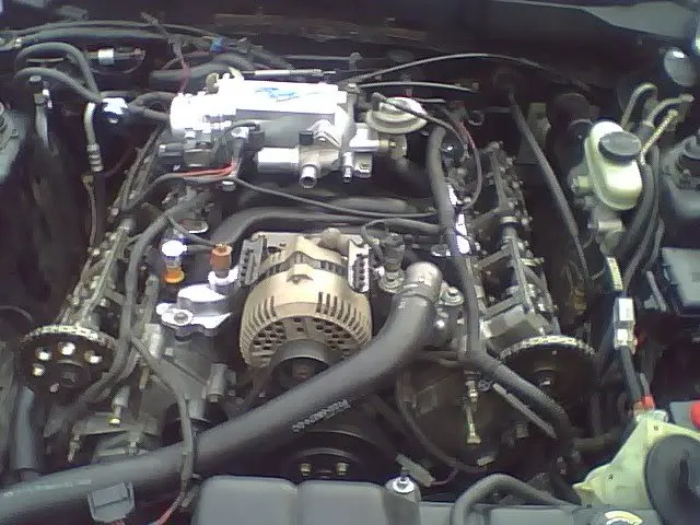

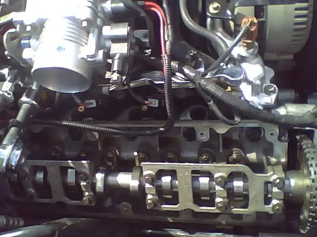

well it took me most of the day, only because i had to drive 20 miles to a junk yard to get pi cam bolts out of a cop car :mad: between this and the pi intake i have noticed a big difference in power, any one that cannot afford a full pi swap i would really recomend doing this
the ones that cam out of the npi cams were too big which i thought was weird so i went to a junk yard that has pi cop car took them out and they fit perfectly
hmm, that's really odd. Thought they were the same. That actually sucks cuz my VT stage 1 cams are PI cams and i can't seem to find the PI washers and bolts i had - must have sent them with the last set of heads i sold off. Guess NPI sprocket bolts wont work on these either
