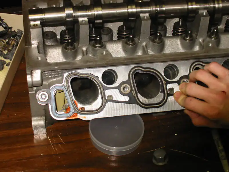

heres a pic, it needs to be RTV'ed on the driver side rear, and passenger side front

For me the PI cams and PI intake were worth between 20-25rwhp. I used NPI gaskets, which seal better for the coolant, but not well for the air intakes. I see most people use the PI gaskets.
