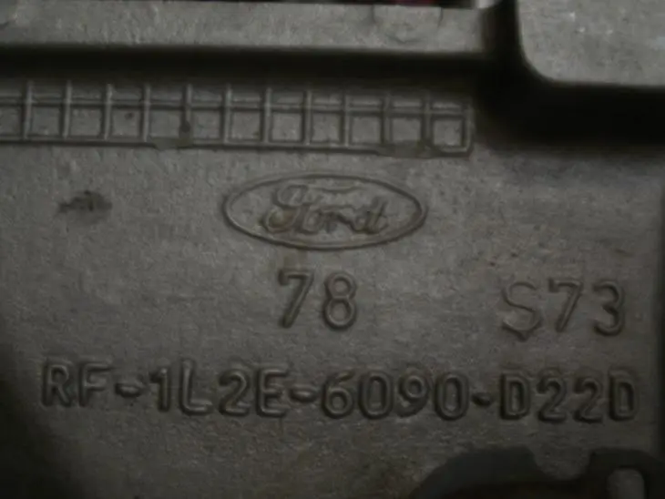

they should be PI heads. Avoid the 99/00's cuz they were made by Windsor and require more work + valvecovers for the swap. Where the casting number is im pretty sure you wont be able to see, but here's mine for reference.

Just some facts to correct some of the wrong info in this thread.
Not every 99+ 4.6 2V have PI heads. The Crown Vic's did not get them( PI ) until 2001 and that is including the Police Interceptor. PI heads are PI heads regardless of what car they came from. So if you are looking at 2000 Crown Vics, they still have NPI heads.

on both sets of windsor pi heads I have there are the letters pi under the casting # by the exh. ports. not sure of the romeo's

dont think romeo's have the PI stamped on them at all

absolutely, always look for the PI stamp. As far as PI heads, never spend more than 100-150 on a set of low milage heads complete. Stay away from police vehicles or anything like that. In general, police, cab, or any other public vehicle have been either used extensively, or have been abused. Some, more than others, but I wouldnt risk it.
Get yourself a pair of good PI heads
www.car-parts.com is always what I recommend. Make a deal with a parts or salvage yard, bullshaz em, and have them send you the heads. Take them to a good machine shop, have them pressure test them for cracks, and if they test out, send them the cash.
The majority of society, especially with the mod motor used in so many vehicles, doesn't know or isn't aware of the value of PI heads to performance enthusiast as ourselfs. Be creative and you can save yourself a lot of dough. If you live close to a big town, chances are there are several sets of PI heads sitting close to you that will go for anywhere from $50-150 complete.
