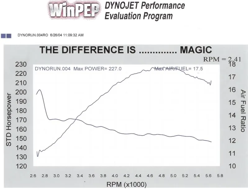

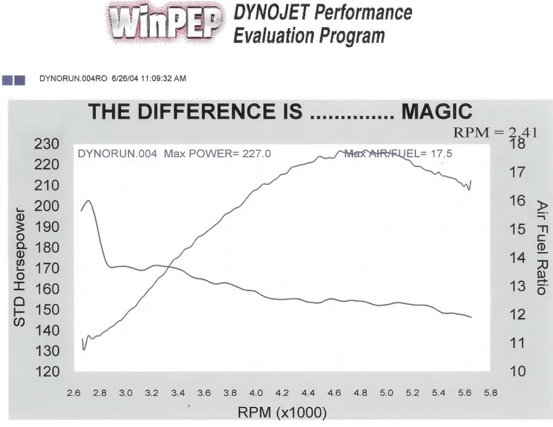

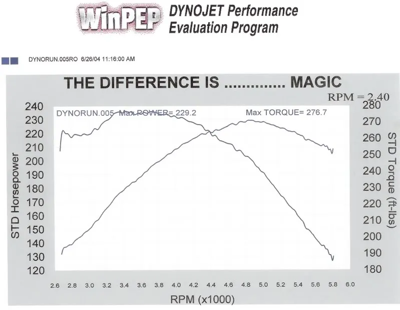

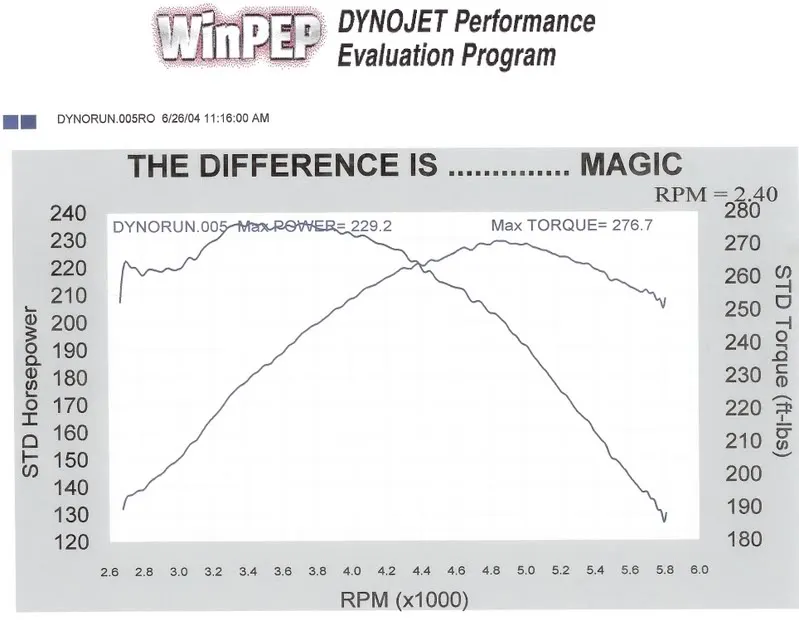

Here is my dyno charts post PI intake and cams. Charts are labeled STD, but were marked wrong when they printed the sheets - they are SAE.
best pull - engine hot
A/F
As for the install, I had pulled the front cover, but if I had to do it again, I would have gone the route of using the cam removal tool from Ford to save time/labor. If you use the tool, just follow the directions that come with the tool. It's really a bolt-in affair. You can leave the intake on the engine which also saves time and energy.
