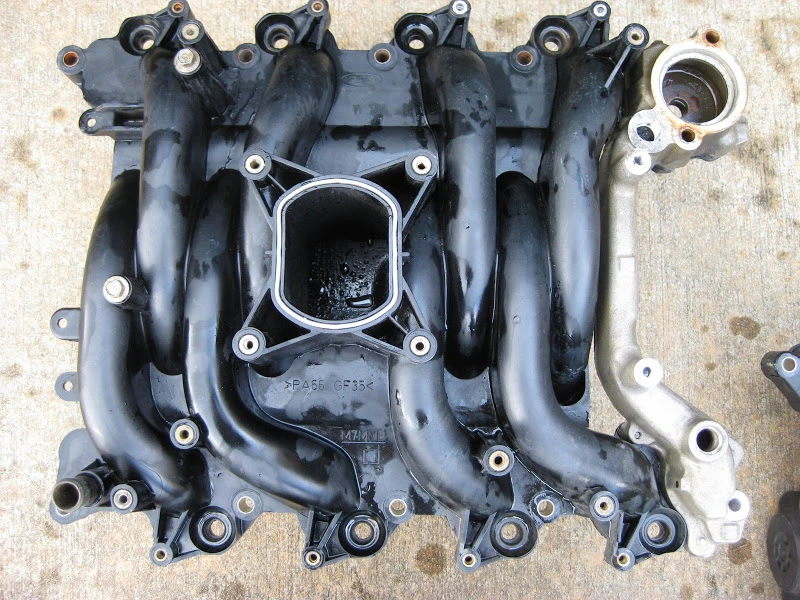

This is what a PI intake should look like:
Notice that the first runner from the front of the intake feeds cylinder #5 on the drivers side. On a NPI intake, the first runner feeds the cylinder #1 on the passenger side of the motor.

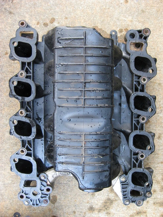

If you can see the bottom of the intake, you can see the rectangular PI intake ports - NPI ports are circular.

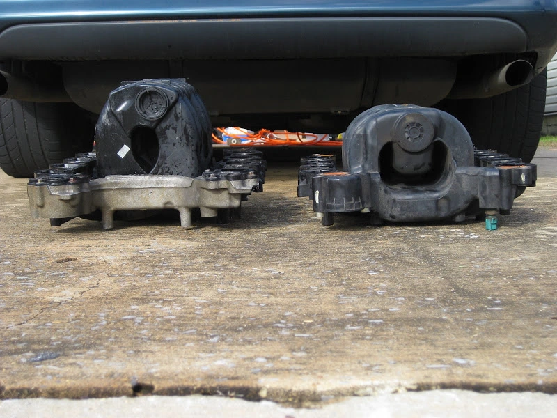

PI on the left, NPI on the right. Notice how much deeper the runners on the PI intake are (the reason you need a new coolant tube for the block valley), whereas the NPI intake runners are much squatter.
