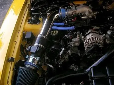

Ok here goes I just got a 98 G.T that is said to have a 00 motor. Well I needed a belt and come to find out the car calls for a 98 belt. But i saw somewhere on this site that if the oil filler neck sits on the passenger side its a pi motor and if its on the drivers side its a npi. Well my oil filler sits on the pass side and the intake manifold is plastic with one sensor hole, from what i can tell it looks prety much like a npi intake. Oh and my car has coil packs that sit to the front of the motor. I really need help to find out what in the world this motor is so i can order a now cracked intake. Any help would be thankful.:shrug:

SD530729.webp ok so here we go i went out side just now a got the code numbers off the driver side white label 9A100AA
Ford Windsor LVL ONT Canada
992006215
064 07-19-99 46L
