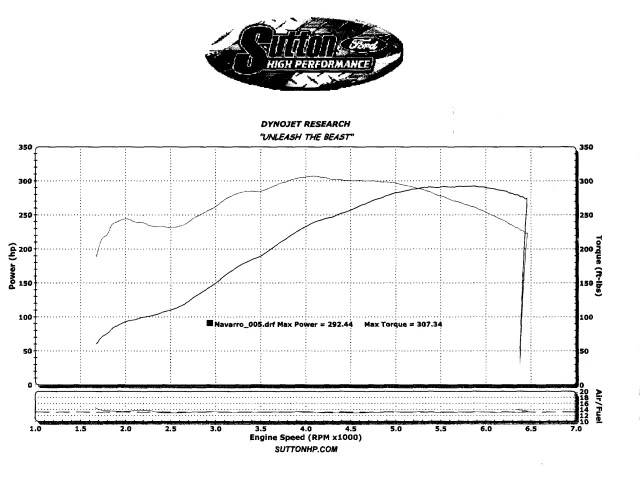

Here are my numbers with almost the exact same setup. You should see higher #’s at a higher RPM. Look at my dyno sheet.
292 rwhp / 307 rwtq
1998 Mustang GT Auto
Modifications:
2001 ported PI heads
CMS Stage 2 n/a cams
C&L intake plenum
75mm throttle body
C&L intake elbow
Hooker long-tube headers
O/r X-pipe
Mac catback
Steeda u/d pulleys
24lb injectors
FRPP 9mm wires
Jerry @ Sutton HP in Mattson Illinois did the tuning with an X-CAL 3.
