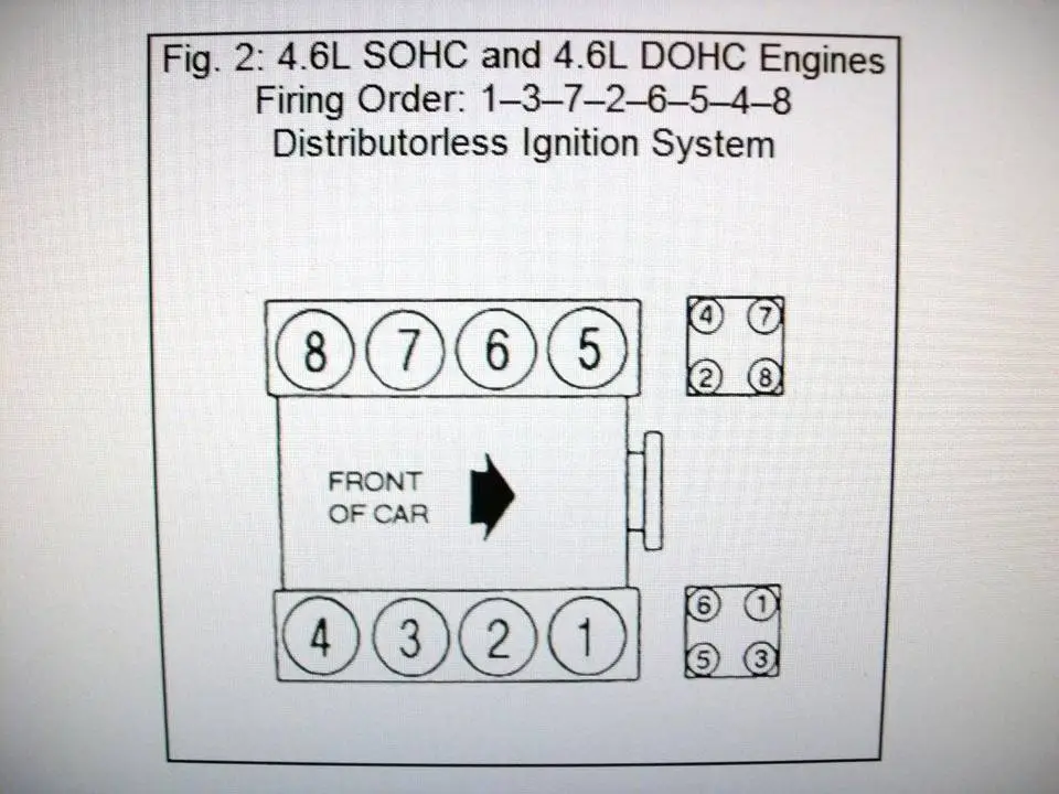

Did you reconnect the spark lug wires exactly as you removed them? Or did you reconnect them according to a diagram like one out of a Haynes or Chilton's manual. The reason I ask is that the only manual with the correct diagram is the genuine shop manual for some reason. All the cheap ones are wrong.
ok is it this one or:
6 3 7 2
1 5 4 8
I have it set for the latter, still no dice, batt is going low, so im going to pick up some spare coil packs and a batt tomorrow..
:shrug: That is partially true!!!! I forgot how I wired it so I had to reconnect them like the Chiltons manual and they did work, but it was different than the original! Maybe I just got lucky. You should change that coil pack first. Even the manual says you should replace all broken and cracked ignition components first. YMMV.
