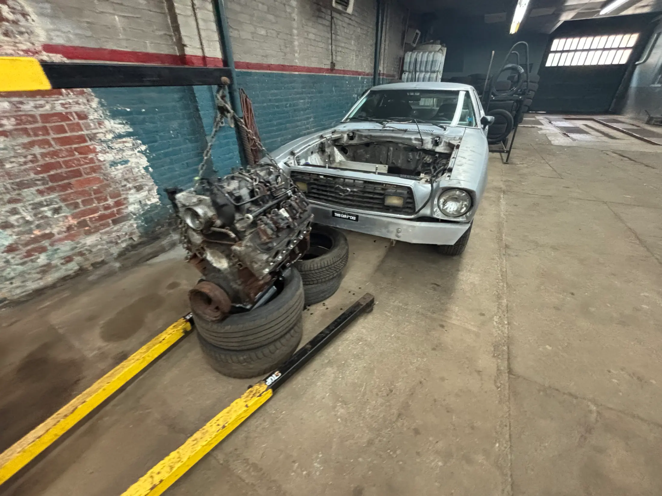

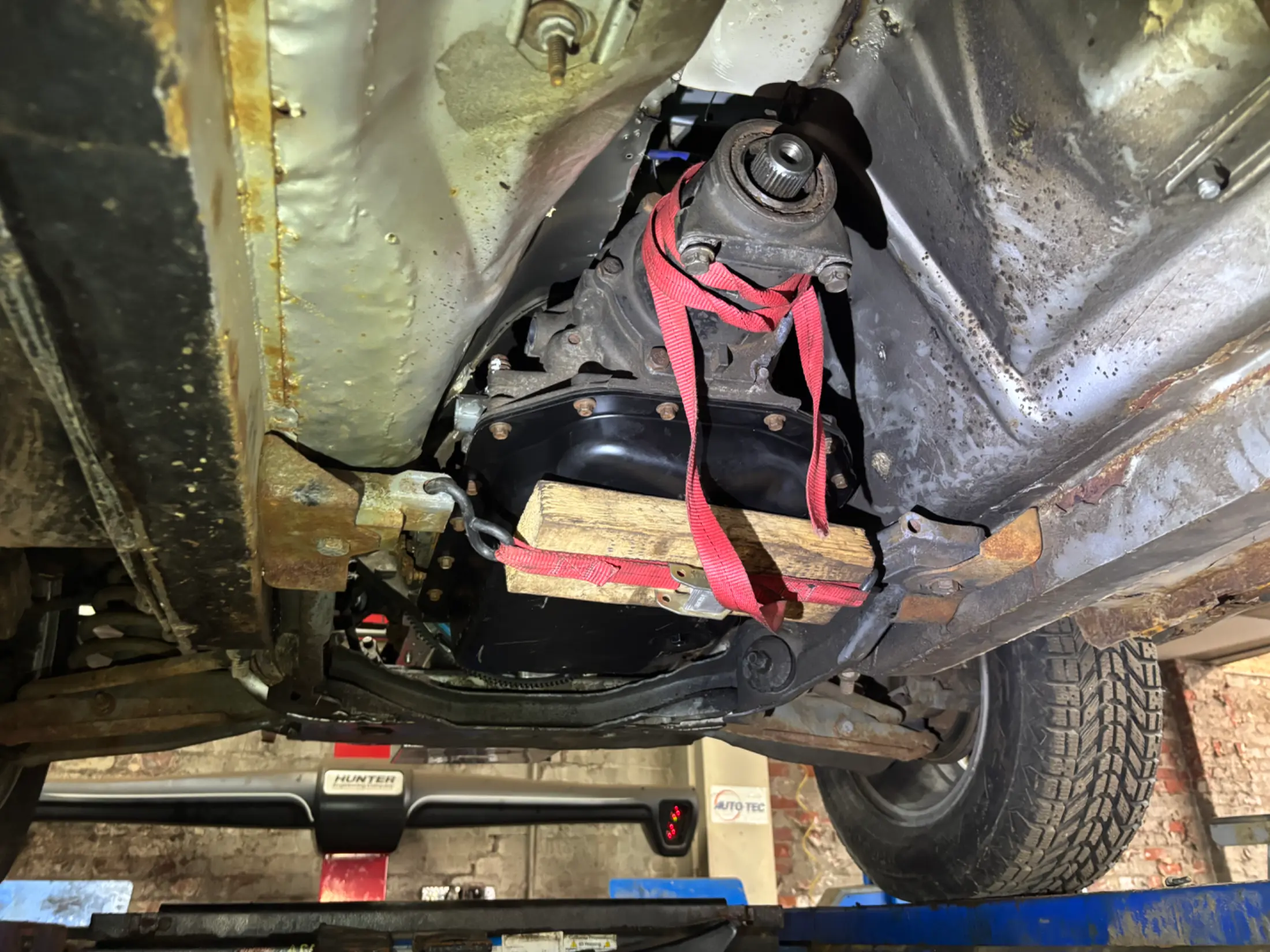

Appreciate the insight. I did get a front sump pan for the motor, so that should clear the rack/crossmember no problem. My main issue i think will be if the transmission fits in the tunnel, but nothing a grinder and welder cant fix

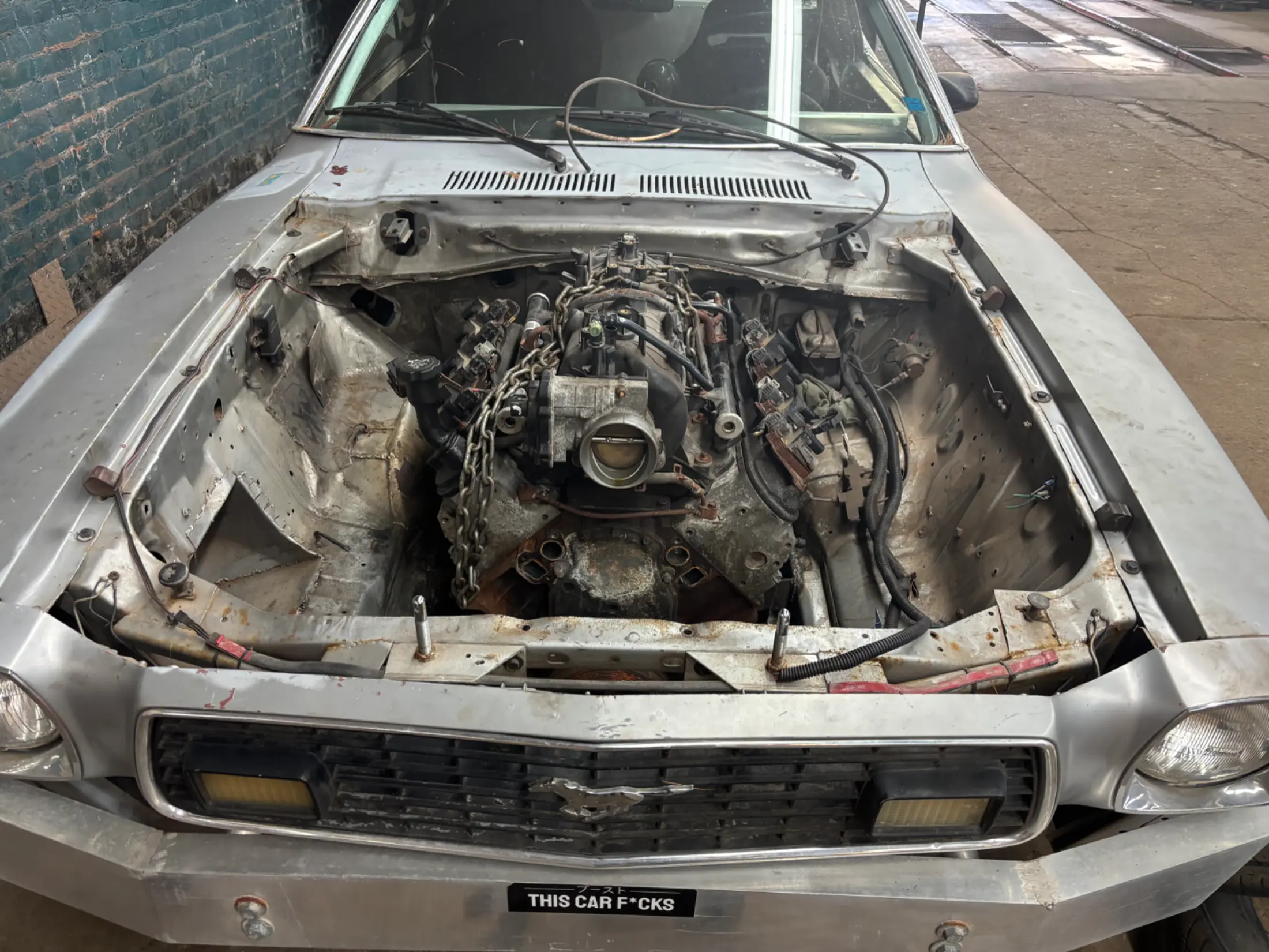

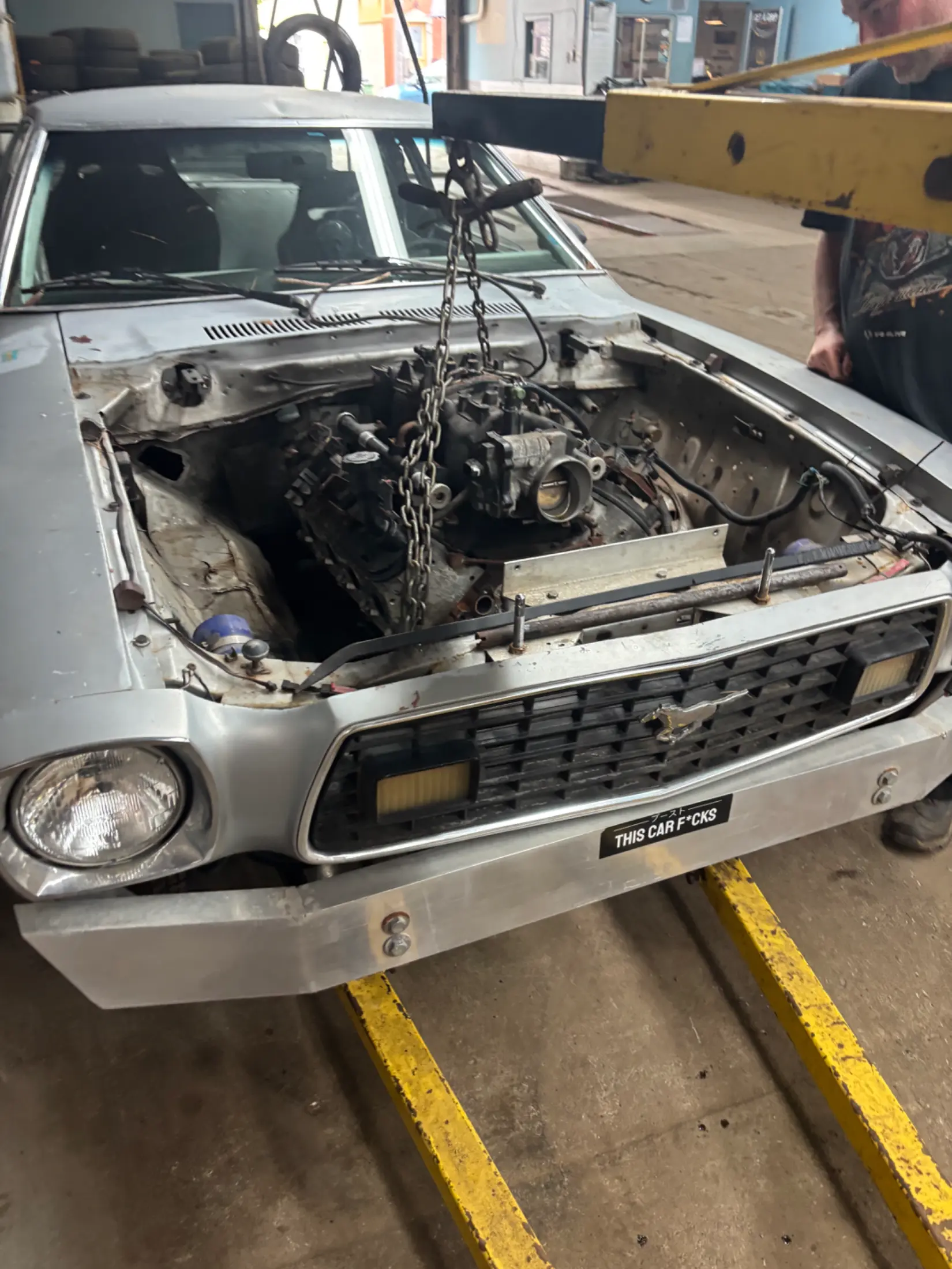

Been waiting on most of my parts to come in, but the front sump pan and universal mounts showed up. Was able to get the car in the shop and the engine bay cleaned out. Motors test fitted in, just gotta cut and weld the mounts tomorrow.
Gonna be tight with the intake manifold to the hood. After everythings bolted in ill have to see how it fits or if ill have to go with a shallower manifold. Will also have to do abit of banging/cutting for the 4l80 to fit in there. And some custom work up front for the exhaust/coolant/intercooler piping. As expected

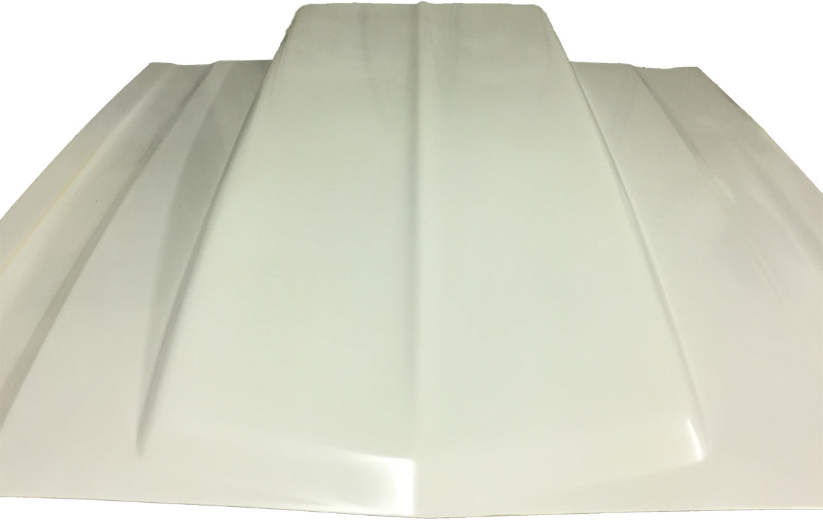

I guess it depends on how much of a "sleeper" look you want to maintain, but there's no shame in modifying the hood for clearance. You could always cut it and install a scoop of some sort, or you could buy a fiberglass cowl hood from some places, like this:
Their other hood  might work, but you'd probably want to do a bit of measuring before committing to buying it.

That hoods actually a pretty good option, thanks for sending that!

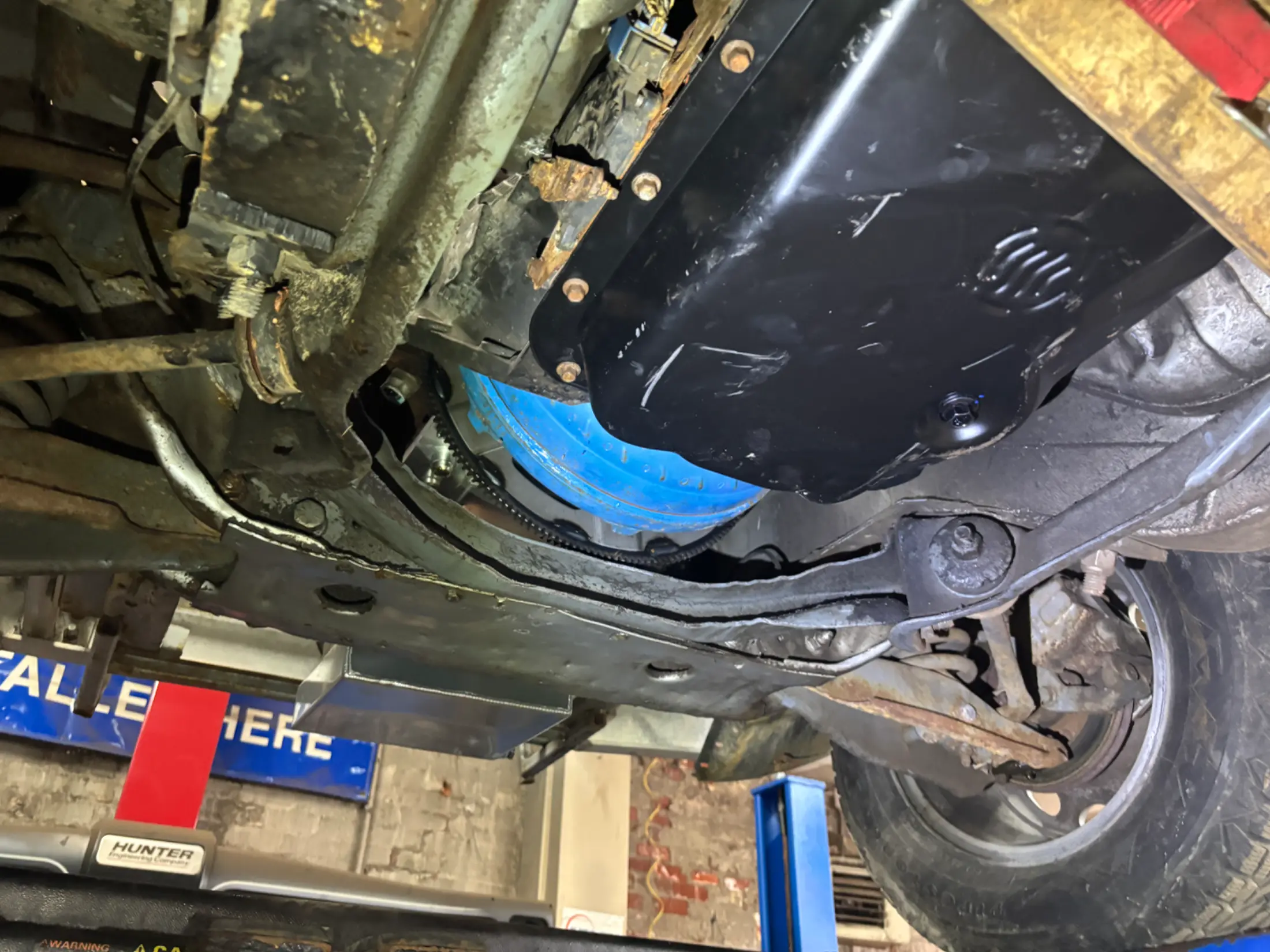

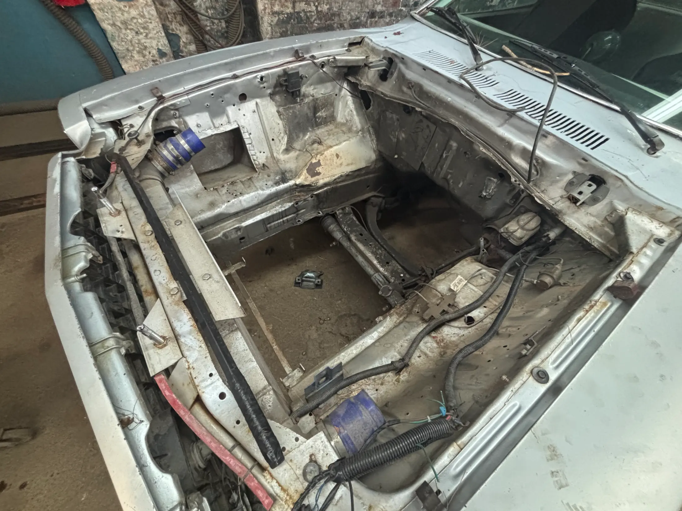

Been waiting on parts to come in but the flexplate finally came and i was able to bang and fit the tranny in. Actually has more clearance than i though. Just had to grind the rack down abit as the pan was rubbing in one spot.
Next is the tranny crossmember, going to fab one off the stock one, putting the harness in, remote oil filter and fuel line/pump so i can do a test start. Once it test starts good ill start fabbing up all the turbo piping
Also ordered an ls6 intake off ebay so i can actually fit under the hood
