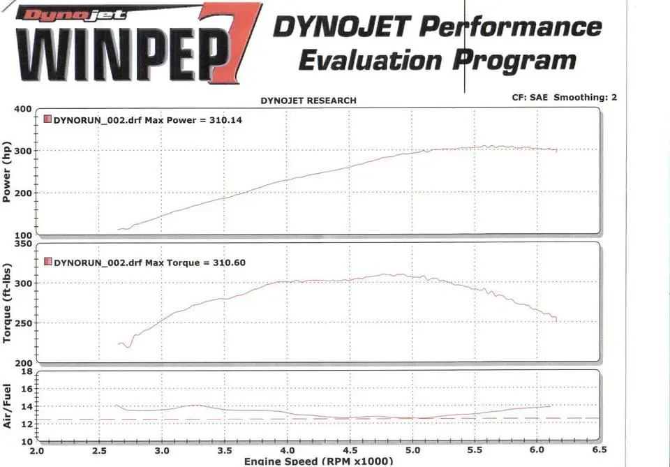

i have powerheads stage 2 cams, but there pretty mild cams, alomot identical to other companys stage 1 cams, 540/540 lift, 225/230 duration @ .50, and a 112 lsa, i made 310rwhp with ported npi heads, 10.2:1 compression and longtubes, (rest of the mods are in my sig) and it has a great tq curve:drool:, and right now im getting my zex wet kit all wired up for a 125 shot:nice: hoping to make about 420rwhp and 450+rwtq
heres my dyno graph
