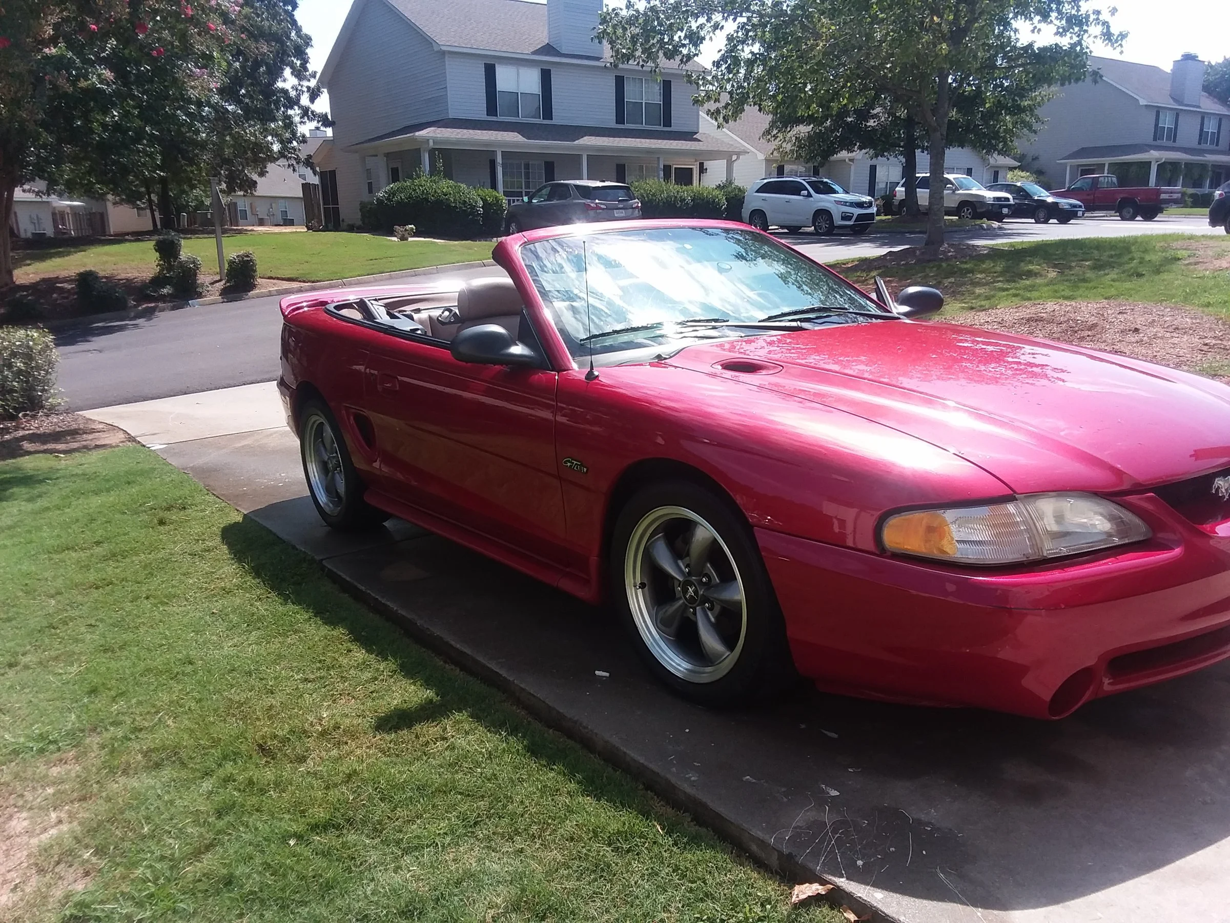

Hi huys,im new to the forum. i just bought a 96 gt 5spd with full pi swap, it still has stock "h pipe" with welded FM 44's, Runs pretty good overall except at wot in 1-3rd gear it bogs down hard around 4k rpm. Its throwing the bank 1 catalyst below threshold effiency code, and was showing a misfire in cyl 1,replaced plugs& i checked plug wires & it had been pulled on from wire instead of boot and was .25" or more gap. So i got misfire solved. But still have the other code and bogging hard at 4k. I bought a new fuel filter to put on this weekend. Any thoughts? Could the stock cats be clogged up? Im not sure how hot car should run but it gets up middle of temp gauge & low coolant light comes on dash on & off
