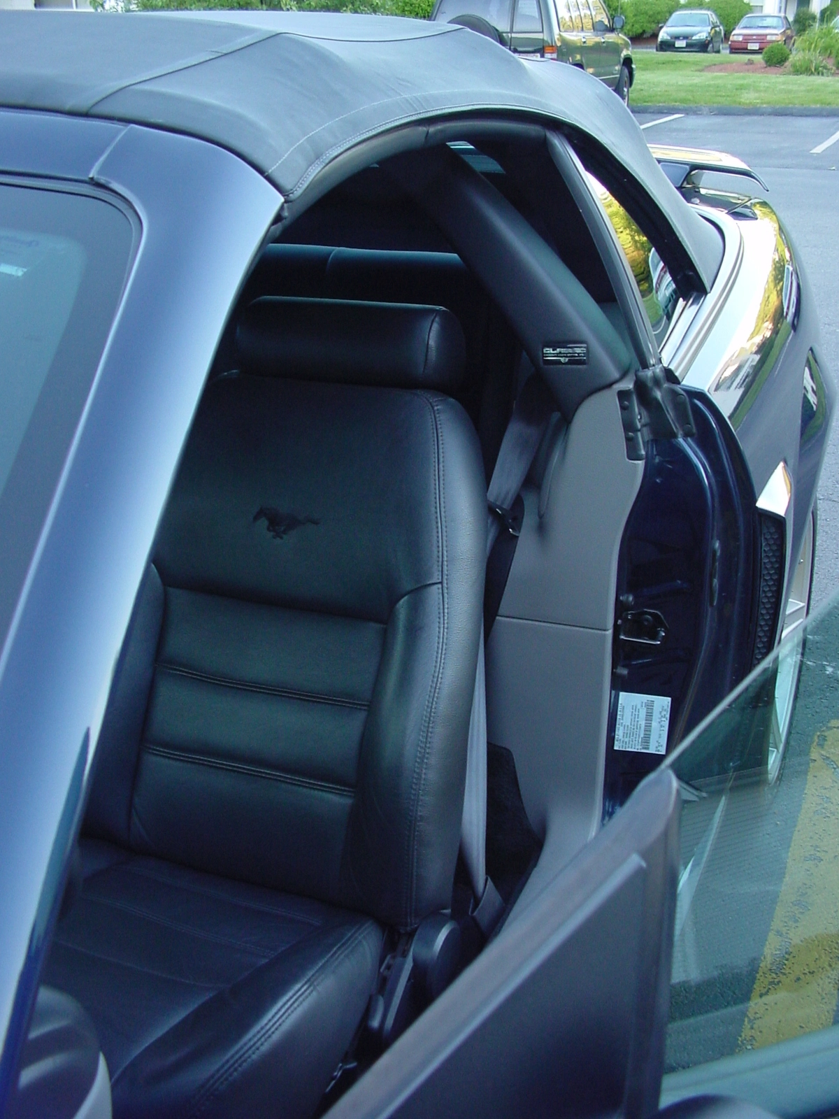

Pic of lightbar installed without trim holes

Someone PM'd me asking for a pic. Here ya go.

I did one many years ago, but it disappeared from the forums over time. Basically you just install the bar with the trim panel loose. Reach in from the side underneath the trim panel and tighten the light bar bolts, then put the trim into place. A bit awkward, but it works fine.
