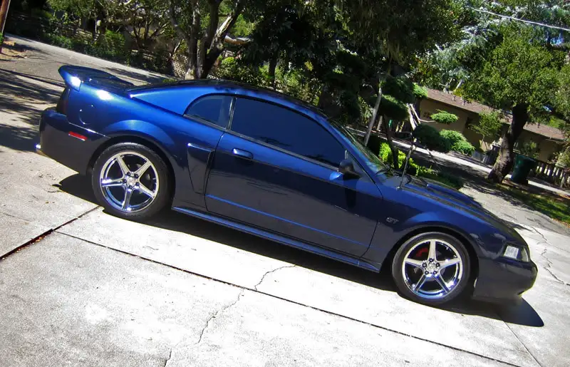

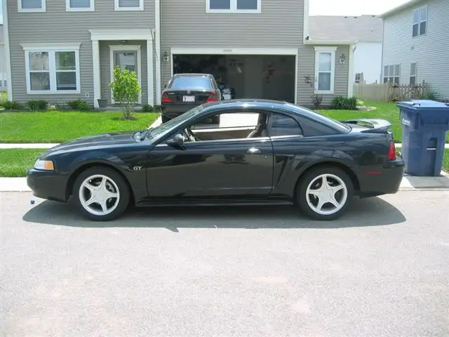

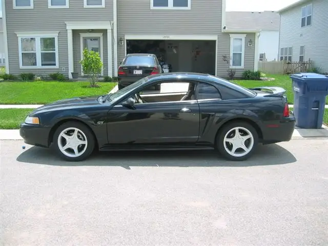

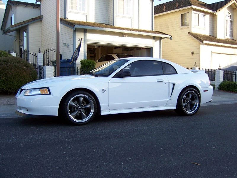

Im lowering my car and i need to see some pics of some cars so i can decide how low to go. Tell me how low you went please. Im going to cut the springs so info on that can help too.
H&R Super Sport springs
BEFORE
AFTER

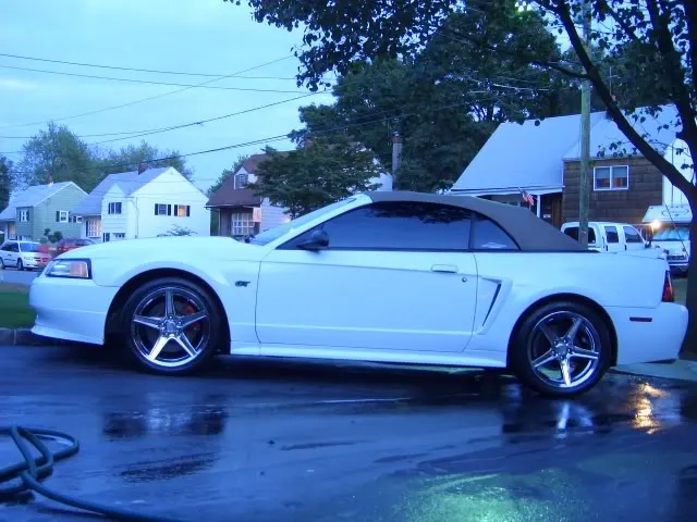

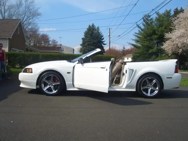

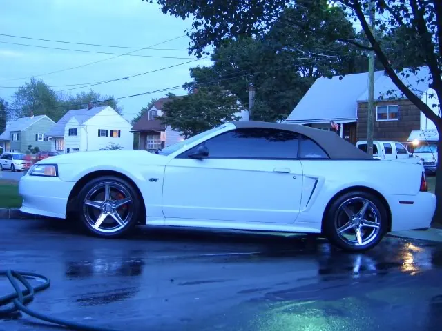

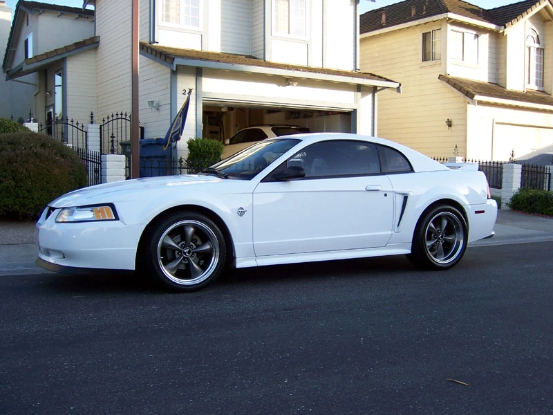

Just get some Eibach Pro for a lower stance or H&R SSs for a slammed look. Either one new shocks and struts is highly recommended.

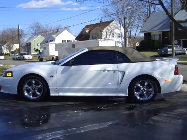

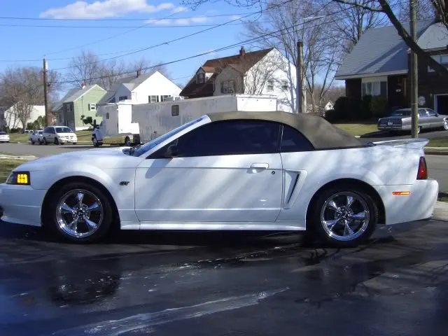

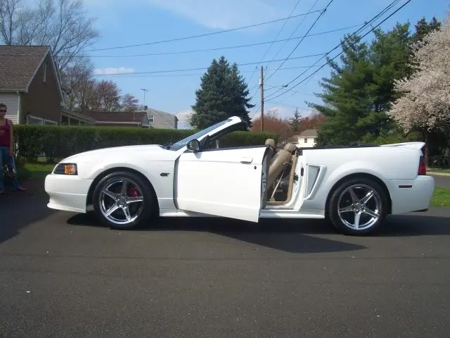

Here is mine on Eibach Pros with 18" Saleens to fill it out nicely:
And here with 17s just so you have an idea:

Hmmm...those 17s looks better than I thought. I'll definitely consider the 18s as more of a "final" upgrade.
