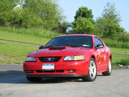

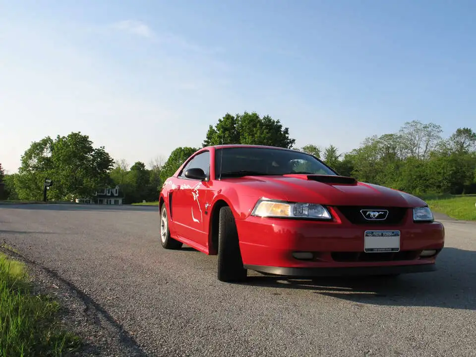

Pic of lowered 99-04
MM Coilovers:

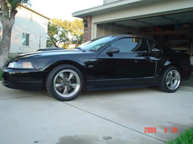

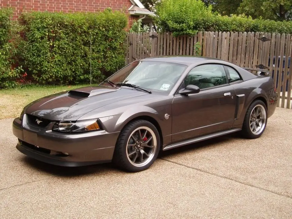

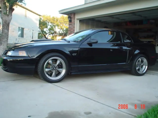

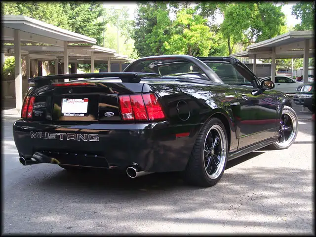

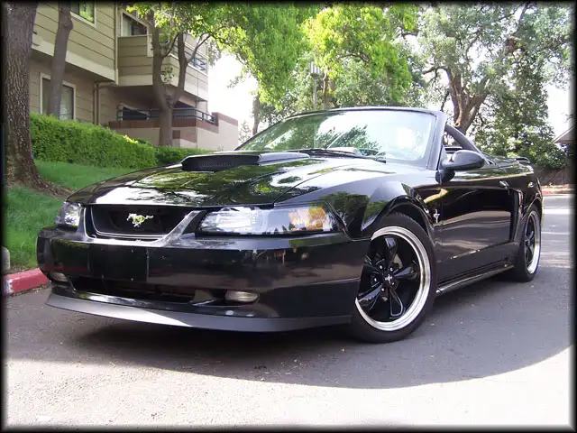

mustangkid05 said:

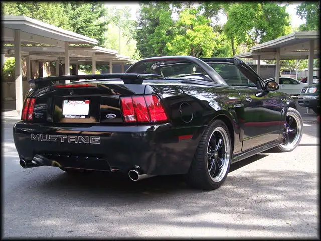

ambo i like......whats youre full setup........(size of saleens, tire size, what kind of springs? and do they rub)?
thanks in advance
Hey bud. The saleens are 18x9 and 18x10 in the rear. Tires are KDW2s 275/35/18 in the fronts and 295/35/18 in the rear. The springs are Eibach Pro. No rubbing at all. :nice:
Former owner did my Suspension a week before I bought it
I love it other than it's a royal PITA to get a jack under it, (or my fat ass)
and it bottoms out TOO MUCH. I cant go over a speed bump without dry docking it on top of it, and on a few ocasssions I've hit a wacky dip in the road and bottomed out BIG TIME at high speed (@&$%(@$%(@)$^%)@
BUT it handles awesome, takes the bumps soft and easy, and actually does a nice Hop Free Launch (more like a ROAST, hehehehe)
I have:
Tokico Shocks & Struts, Ebiach Springs, Urethane Body Bushings, & Caster Camber Plates
For those of you with csprings, did you cut the rear? Mine looks like stock height, and it's been several months of settling in.
I make it so that the rear coil points toward the drivers side correct?
I'm pretty happy with the front after I removed the isolators, but it made the rear sit up another 1/2 inch or so :(.
