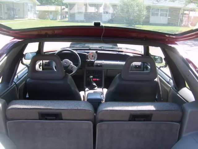

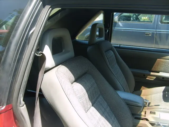

Went to the local salvage yard this morning looking for a door for my gt. Ended up buying a set of halo's. Should have done this mod a lot sooner.
Color is off just a little off(had to dye them, they was tan to begin with)

are those from a mustang or an escort? mustang halos are hard to come by these days

There off an escort

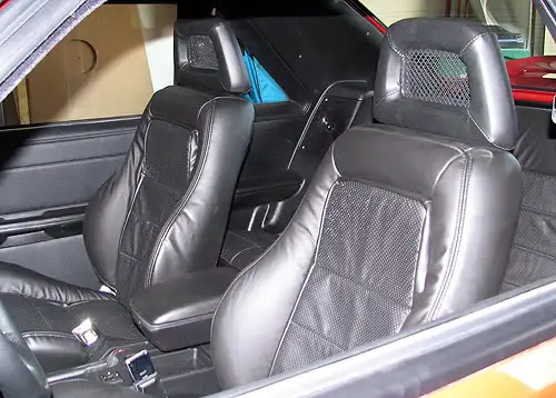

heres mine

Had mine wrapped in leather to match my seats..

That looks really nice^^^^^^
