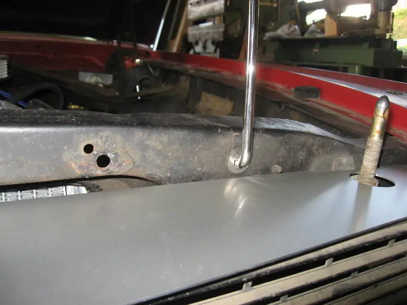

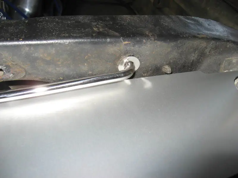

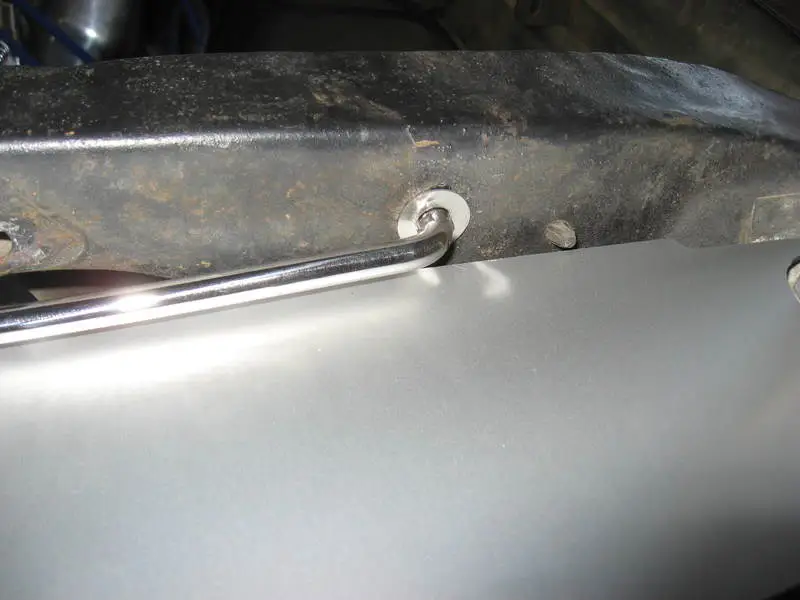

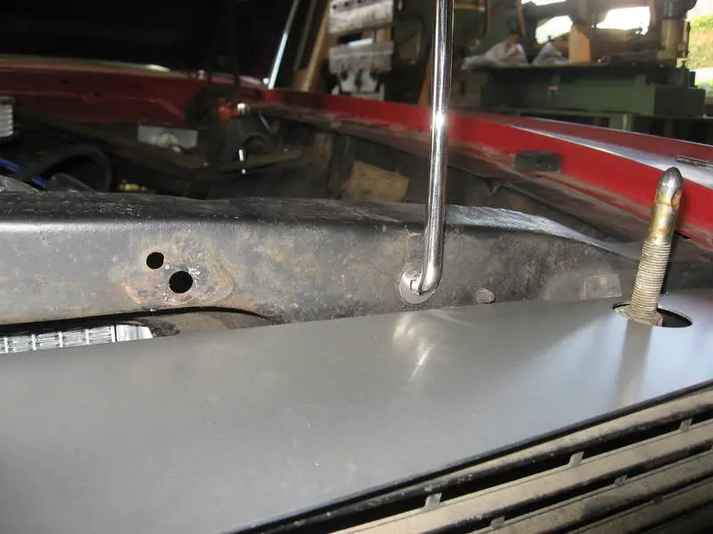

I use the s.s. prop rod available from most vendors. I think I buy them at Mustang Depot. One quick hole and you are done.
^ me too, the top of my prop rod sits in the pass side hood pin hole thru the support and rests on the underside of the hood itself (2 layers on my glass hood, support and hood itself). The horn wires make a nice holder for the rod on the driver side when stowing the rod. sorry no pics, Im at work.
