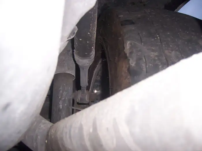

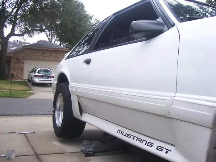

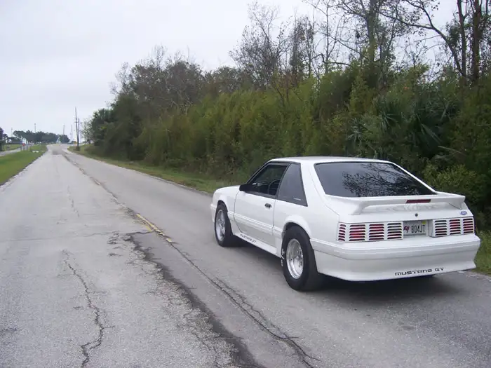

mob the guy who hits on his mom 20+ Year Stangneter Oct 3, 2003 2,566 136 104 Dallas, TX Apr 5, 2006 #2 Apr 5, 2006 #2 I have 15x10 with 5" backspacing and 11.5" slicks and had to do NO mods, quadshocks are still there Attachments 000_08672.webp 13.5 KB · Views: 141 000_08731.webp 41.1 KB · Views: 191 000_08561.webp 31.2 KB · Views: 169
