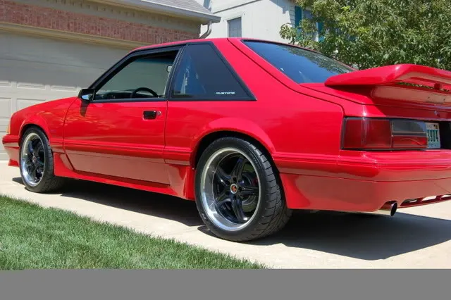

My '89 with full Cervinis kit, including the double stack wing..

Your car just made my decision!
How was the fitment? Did you use the double sided tape and screws that Cervinis provided? How is the double tape holding up as far as the seams where they meet the body? I really like the way it looks.:nice:

Thanks. The kit has been on almost 2 years and is holding up well. We used the tape and screws, but we added a couple screws in the front, and an extra screw on the door sill to pull up the side skirt. I'll see if I can find pics.

thats one sweet looking hatch. If you don't mind me asking what are the specs on your suspension and wheel tire combo?? looks baddass!!!!
Thanks!
Wheels are ROH Drift-R 18x8 25mm offset with 235/40 Nitto 555, 18x9 24mm offset with 275/35 Nitto 555
Springs are Saleen Racecraft with Kenny Brown Trackit Brackets in the rear (lowers LCA by 1/2") and Tockico Blues
Fox length axles with North Racecar brackets
FRPP 13" and 11.65" 4 wheel disc (Same as '01 Bullitt)

from what I can see, that looks real good! Any side views?
Sure. Heres 3 for an idea..
I really like the Saleen type ground effects, it gives the car a good flow. Don't mind the ****ty alingment of the ground effects. I had a body man put them on, to bad they don't care enough to do a good job on it. I tore them all off during my build up and will be putting them on myself so i can get them perfect. Lesson learned there, just have body men paint your stuff. Then YOU install it, their work doens't reach my high standards :nonono:
