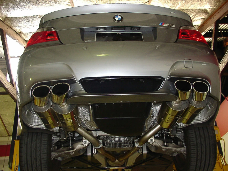

I've really thought about that, actually. I think with the right fascia it could be pulled off, just like on that M5, but to get it right, I think it would require fascia that's not on the market and swapping the fuel tank to one that's smaller. I haven't had a vision that's right yet.
