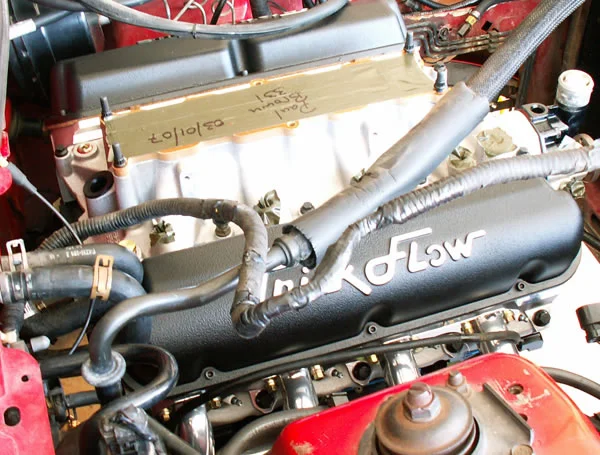

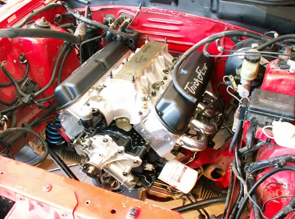

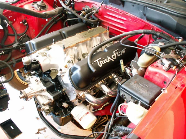

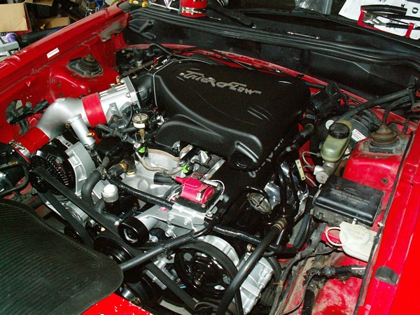

Pics of my 331 Trickflow build....
I didn't take any pics with the intake on, but I'm sweating the hood shutting. It's definitely higher than the fenders. :D
Old engine pics are here: http://forums.stangnet.com/showthread.php?t=694972
Thanks guys!

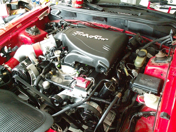

Waiting until I have a few more pieces on the engine. It'll probably end up being close to the stock location. I was hoping to move it to the driver side, but that's not happening very easily. The new intake is WIDE. :D

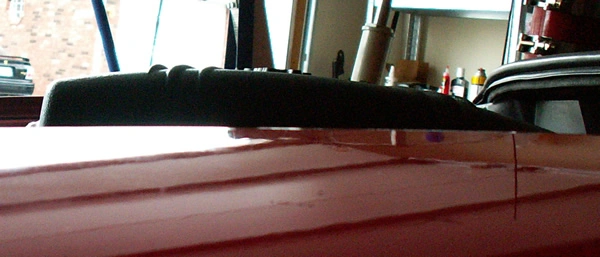

I took these this morning on the way out of the garage. Sorry the lighting was so jacked up.
Here you can see how high above the fenders the intake is.

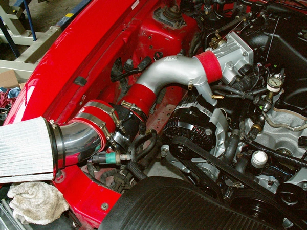

I'm still mocking up the cold air I pieced together.
I HAD to have an 8mm 12 point socket for two of the intake bolts. You can't get this at Oreillys. They only sell 9mm and larger. :fuss:
Thanks to Diff-man (buddy with a transmission shop) - I was able to borrow a socket and proceed with the project. I had to modify the upper intake, file away at the housing, so I could put a wrench on the back 12 point nut. :nonono:
Then I had to cut a 1/4" off the lower front stud for the SN95 elbow. Now the tricky part is getting the air filter in from the underside, and cutting the couplers to the right length to space it all out properly.

3/8" spacer. Yes, UNLESS you grind the EGR bottom bolt hole off the elbow. It is the track heat. I'll know tonight if the Cobra hood will clear, but I doubt it. I'm actually not sure if it was the mounts that lifted the engine up. I do know is leaning forward a bit, as I don't have a transmission on the back of it. ;-)
The intake/fender picture is why I'm looking at this: http://forums.stangnet.com/showthread.php?p=6853990
I KNOW it will clear... just not sure what brand it is, and I'm concerned about fitment around the headlights.
