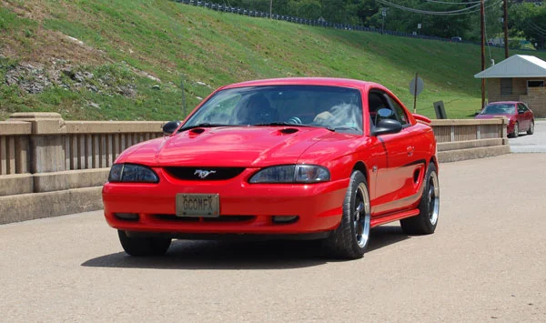

Might as well add another picture of the car while I'm posting an update. LOL
