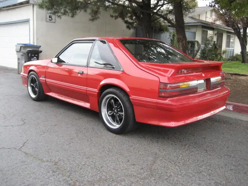

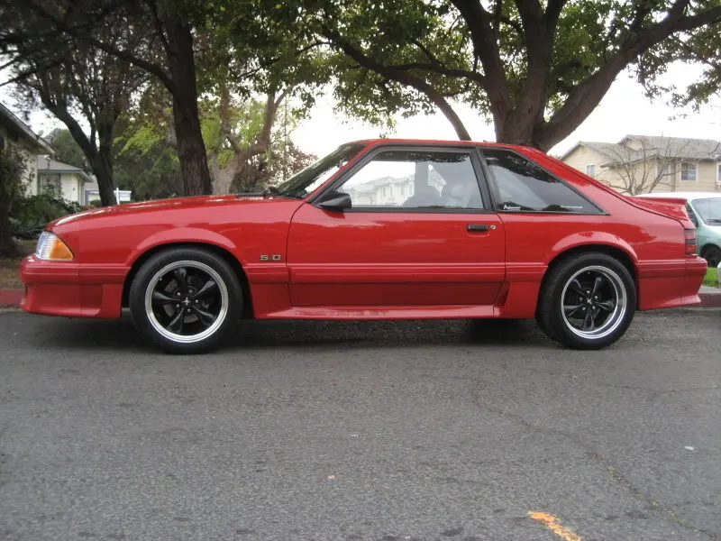

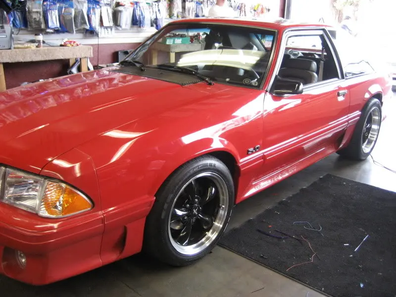

Okay guys here is a picture of my mustang with deep dish bullits 17x10 with 315/35/17 nittos and 17x9 with 245/45/17. I just order my fr500 in chrome 18x10 with 305/35/18 and in front 18x9 with 255/35/18 ps2 tire... I cant wait to see how they look...On the picture my car is dirty wait until it get washed :D
no rubbing at all I put 1/4 inch spacer all around .. No quad shock, I just bought upper and lower control arms they work good steeda..But I'm planing on putting on coilovers when I get my fr500 .... This is 50resto 5 lug conversion kit with drums in the rear, But now I'm going with rear dics.:flag:

did you roll the rear quarter lip or beat in the inner quarter to clear 315's? Any tailpipe issues?:shrug:
by the looks of things ide say the car sits high enough in the back to not need any clearance. ide say if it came down the fender would hit the tire no matter what.
the 18x10s tuck in alot better. be prepared to beat the inner fender at roll/cut the lip if you want it so sit low in the back.

No centercap issue with the bullitt wheels on the front rotors??
