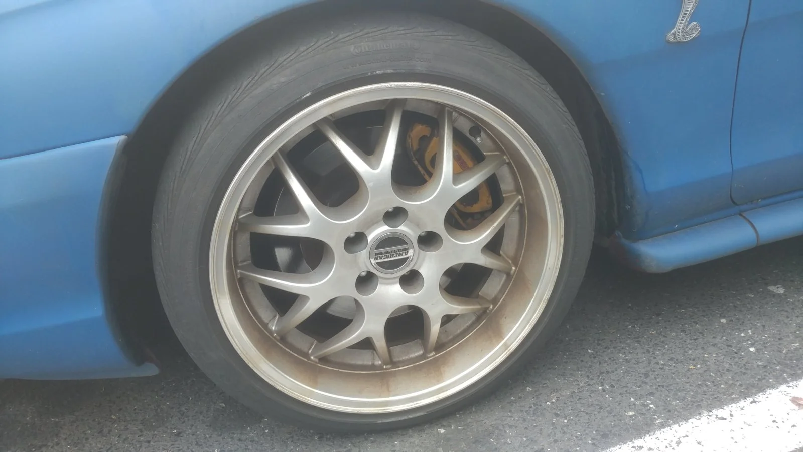

Hi All,
About 4 months ago I bought a '94 Cobra and got some real good input here with some questions I had at the time, now I'm back hoping for more. Bad news is I haven't much time to spend on it, lent my "practical" car to a family member so the 'stang has been my daily driver. Good news is it's running great and with the holiday season over I'm gearing up to throw some money at it. I bought it from a guy who didn't know jack about it and it must've been an owner before him that did the modifications, so I'm piecing it together as things go along.
First order of business: It's got 18x10 inch rims with 245/40/18 all the way around so the tires have a slight stretch. The rims in the front are too wide and scrape on tight turns, which is what I'm hoping to eliminate. I plan to keep the rims on the back but get tires with a decent sidewall - any recommendations on what size would work well?
My concern in the front is that the car is lowered slightly and if I move to 18x9 with a decent sidewall I might scrape the tire against the inside of the wheel well on turns. So I was thinking about going to 17x8 on the front with 245/45/17... Any recommendations on how I can make sure that will fit? This weekend or next I'll be able to pull them off and do some measurements in the well, I'm pretty sure the current wheels have a +24mm offset, but would need to verify. How concerned should I be about scrub radius? Anything else I should definitely look out for? Added a picture of the wheel, because why not.
Thanks in advance.

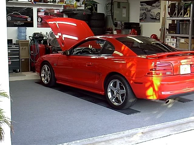

Let’s see some pictures of the full car. We can probably make judgement calls from there based on the ride height. Vast majority of SN owners run 18x9s up front and 18x10s in rear. I had 17s on my SN because the tires were much cheaper and I was young, but 18s are the best look in many’s opinions.
I had 03 Cobra's in chrome on my 94GT, looked fantastic.
275-45-17's all around. However after I sold it the new owner had the rears cut in half and welded in some material. Then he added a 315-35's out back.
With 275's

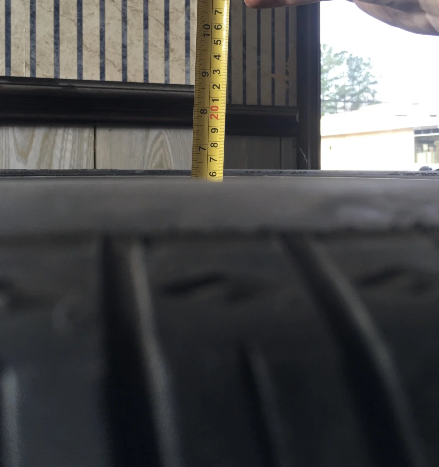

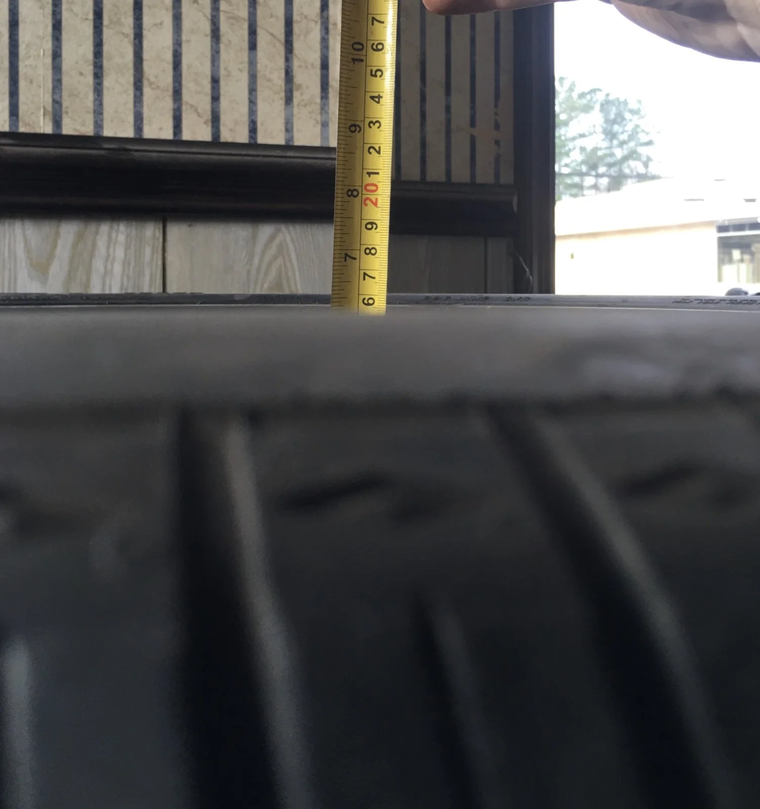

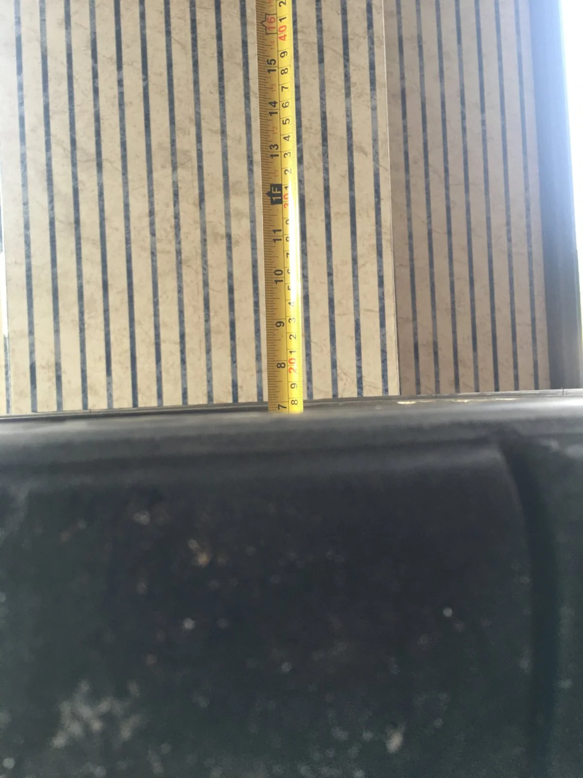

These are what I ran in a 95 with just quad shock removal and a little bit of hammering on the inner wheel well. No rubbing whatsoever, unless I was fully turning on the stops, but even then it was extremely minor.
The fronts are up top and rears at the bottom.
Sorry I didn’t have a straight edge to measure. I had 275/40r17 on the front and 315/35r17 on the rear.
