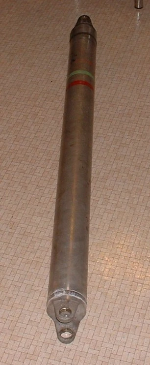

The driveshaft came back from being shortened today. Looks like it will work great for the T5 swap.
Since it's made out of aluminum it's very light. According to my bathroom scale it weighs in at only 6lbs!
The shaft was $25 from the local wrecker and cost an extra $25 to get shortened compared to what the stock shaft would have cost to be shortened. So I'm into it an extra $50 over what it would have cost me to have my stock shaft shortened. Total cost will be around $150.
The guy at the transmission shop thinks it will be plenty strong. He said I'll snap off the T5's input shaft before the driveshaft will break.

Here's a shot of the whole driveshaft. It looks like a monster next to the stock shaft as it's 3.5" diameter instead of the stock 2.5".

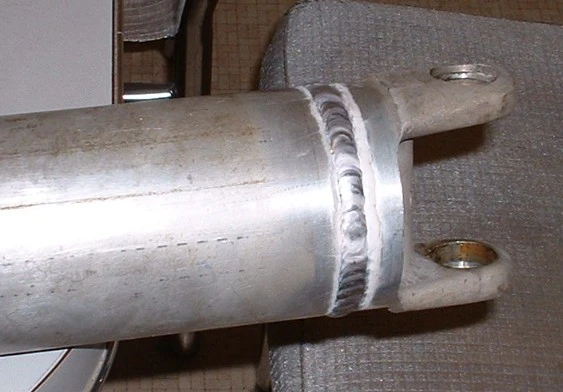

I used an aluminum driveshaft out of an Explorer, I think. (It was on the ground next to an Explorer at the junkyard). I originally bought an Aerostar driveshaft, but it had crimped on ends, and the driveline shop would only shorten welded ends. I can't tell from your photo, but was it originally welded or did it have a crimped on band?
Mine was factory welded. The other end still has the factory weld.
Here's a pic that shows the weld. This is a pic of the aerostar driveshaft next to a stock 5.0L mustang driveshaft(which is larger in diameter than the stock 70' shaft). This pic is from before the shaft was shortened and when it still had the aerostar input shaft attached.

They want 225$ around here for a new driveshaft. My stocker has a harmonic, I'm pretty passionate about not having any work done to it. Stupid two piece driveshaft!!
Anyway, this looks like the way to go. Assuming they don't chew up all the shafts with fork lifts.
Just make sure you have the room. Aluminum shafts are much larger in diameter than your stock shaft will be. There is plenty of room in the transmission tunnel, it's the exhaust pipes you'll have to worry about. I might need to "tweek" my exhaust a little.
