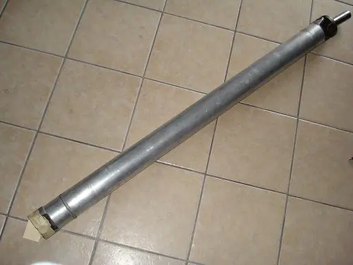

Anyway here is what I found right up the street from work for $40 and after a quick scrubbing/degreasing:
I probably could've found one cheaper but this was literally less than 1/2 mile away. It was marked "92 Aerostar Stick" and "Not Aerostar" and is about 61" minus the slip yoke and flange mount. The slip yoke fits the T5 and is even the same PN as the one that came out of my 95 parts car. I am dropping it off in the morning to be shortened.

I just got mine back from the driveline guy today! 51" is what i ended up needing. I have a 91 302 roller, T5 and 91 bellhousin and an 8" rear end.
The guy I went to said the shaft is plenty strong up tp 500ftlb of torque! I cant wait to get it in!

Picked mine up today and it fits like a glove!
I had to swap out the rear flange because the bolt pattern was different than the mustang rear I have under the car. I spent about an hour at the parts store measuring u-joints until I found 2 possibles, lucky for me one of them fit :nice: No idea what the original application was though.

You don't use the Aerostar rear flange. The Spicer joints I listed earlier in this thread fit the 8" rear and the stock saddle bolts. If I remember correctly, it was just a new replacement part for the 8", 65 Mustang in my case.
I am using a flange, from a late model mustang not the Aerostar, because the rear differential is from a 95 GT. Originally the shop was supposed to only shorten the shaft but they assembled it with new u-joints and everything.
