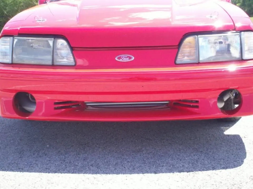

I use to have a dry kit on my car, then I found turbomustangs.com and it changed my mind...lol When I did this build I also decided to fill the holes in the engine compartment, add a tubular k-member, and a-arms. Heres some pics!
BEFORE PIC
HOLES BEING WELDED AND FILLED
Hers pics of the cold side going together.
Vortech blow off
Here's a pic of the charge pipe entering the engine compartment, and the 3.5" Downpipe.
B&G wastegate
And finally the finished product!
how much you think you got into it total? what heads are those. stock puter? looks good any numbers before after? peace
john :p
I'm not really sure how much I have into it. I probably have about 3000 into the turbo kit including injectors, mass air, and fuel pumps. The heads I have are Trick Flow TW they have also been ported and flow just over 300cfm. And I'm running an Anderson PMS. The car before the turbo went 11.67 with h/c/i and a 100 shot. I'm going to the track in about a week and I'm hoping for mid 10's or better.

I have a 9lb. spring in the wastegate, but I have a boost controller so I'm going to turn it up to about 12-15lbs. And it feels strong. It's a night and day differance from the spray. When the car starts making boost it just pushes you into the seat.
