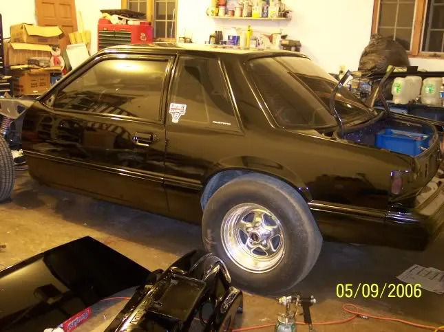

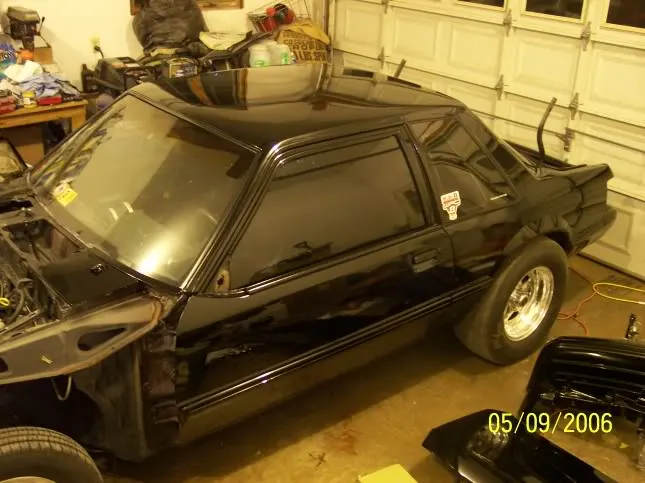

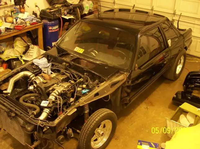

Well any of you guys that have kept up with my project here goes another big step out of the way. I finished painting most everything today and all thats left is the re-assembly of the body parts. This could be the best looking V8 to 2.3 swap car painted outside with a $40 siphon feed gun ever.
All of the turbo stuff seems to be up and working great and I hope to catch a test and tune thursday.
Its funny when you go back and look through the threads I've started and posted pics on. Look at the dates on the pictures March 1st this was a running, driving 351 car that I drove into the garage and began tearing apart. Now in 2 months time I've gone back to a pretty wild 2.3 turbo/ 5spd. Its another junk yard engine but this time it has a nearly all of the stinger bolt-ons and a holset. I've also painted it, done the 5 lug swap, built a new rear, and already made the fastest runs of my life and its yet to make it down the track without an engine miss.
