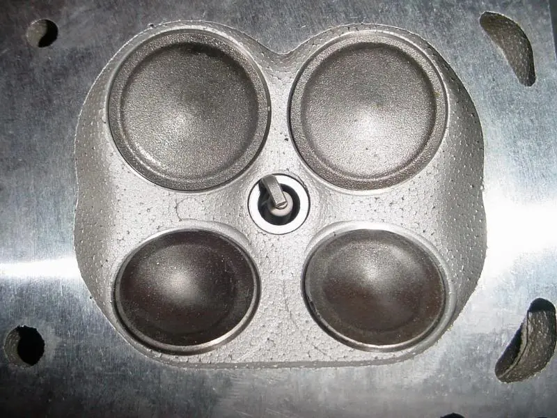

As some of you rember the saturn i bought for $1250 had some wacky idle problem... I did a tune up and upon pulling the plugs i found 2 black and 2 white :shrug: . I did a compression test to find two dead cyls. I thought head gasket and was told by a shop it was $1100 to fix. I figured it wasnt worth it and it was time to see what i had learned from working on the stang and probe doing small things over the last 2 years.

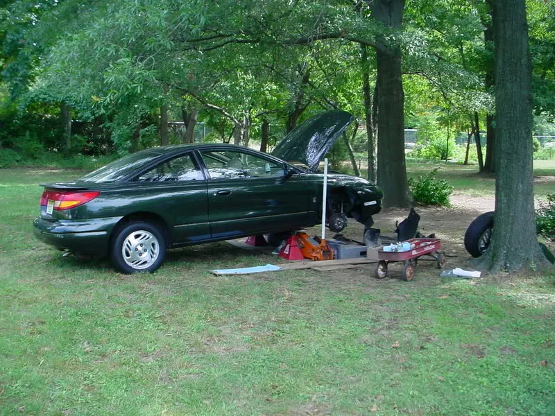

After finding no compression i decided to pull the car in to my garage and pull the head.
After pulling the head i was puzzled.
The head gasket looked fine...
So did the block....
I flipped over the head and found...
2 burnt exhaust valves... I looked around for a used head but then id figured i might as well just get some new valves put in... $510 later i now have a fully rebuilt top end with all new valve seals and guides. The guy at the machiene shop said more then 2 valves were on their way out... so replaced most of them.
I Picked up a new head gasket and new head bolts and went to work putting the head back on.
When installing the camshafts 1 bolt would not torque past 100in/lbs... it broke in the block....:bang:
i was able to get it out now im waiting for 2 bolts to come in at the saturn dealer...
:doh:
But so far i guess Ive done alot with what little i know. My grandfather has been helping as well... neither of us have a clue :rlaugh:
i wonder y the vales burnt... the guy at the machiene shop said its a common problem on saturn dohc engines... he also said that it looked like the engine had head work done b4 he found that all the intake side looked beand new...

When i pulled the spark plugs i found plat 4's i think that might have caused the valves to burn.... i know some cars have problems with them. Im gonna keep my eye on the plugs pull one every day or so just to make sure...
Did the machine shop clean the passages in the head, seriously man I'm trying to save you time and money. Find those pieces! they may be in the cats, if thats the case they can screw up the cats, a hot piece of metal can bond to another, the that gets hot and melts....... and so on and so forth, I lost my cats on my bassani pipe from this crap.
yea i checked the block there was nothing on top of the pistons and i drained the oil as well. they probally burnt up and went out the exhaust valves... i checked around just to be sure.
There is a precat in the actuall header it would be there it probally has fallen out... there is no way to check that precat without sawing off the header primarys. The head was hot tanked and fully cleaned so i know its not in there
