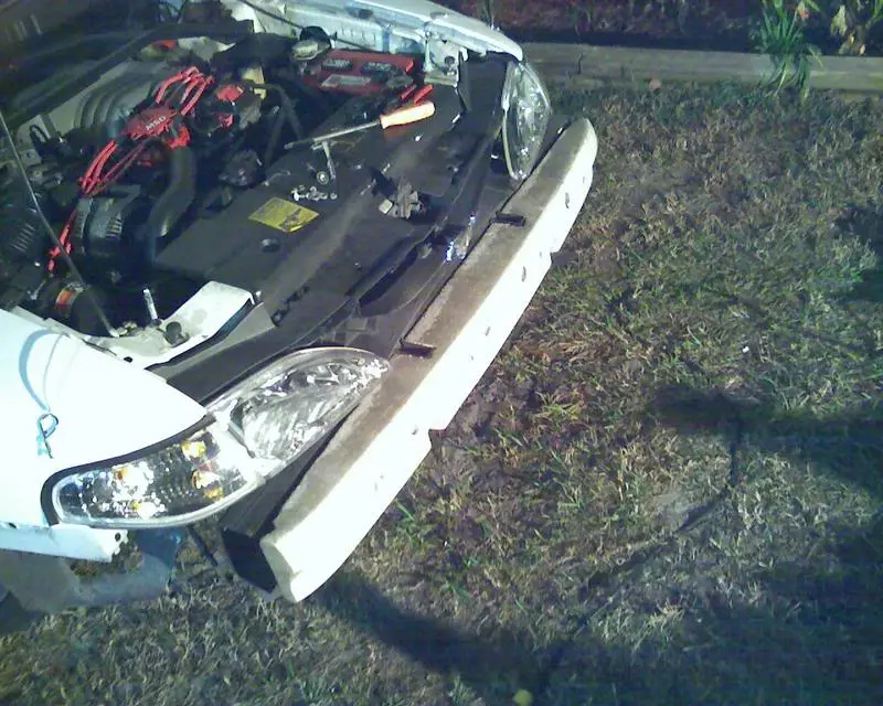

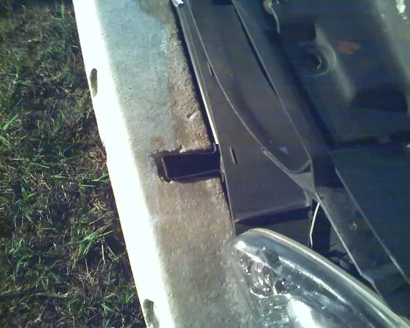

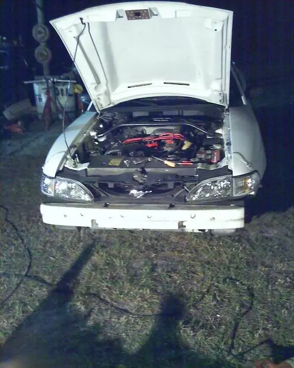

Well I figured something out with what I had. couldn't find anything showing an sn95 style so I just did some modification and fix her good. Fit like a glove and the bumper has no more sag to it so that's a plus.. here's some pics of my riggin lol

if I am correct to remove the front bumper there are two bolts in each fender, then there is the plastic pushpins on the rad support, then to get the bumper cover off use a butter knife and somewhat use it to pry the cover where the headlights where( there are tabs you have to push down.).:nice:
Ive taken my cover off once. sorry no pics.:(
I thought the foam was riveted to the support beam:shrug:
Now what I know what you mean.
The pics will help others though.
thanks for the info... yeah I've had my cover off a few times before but just never knew how the foam went on there. I thought it may have been attached somehow to the two mount looking things that are on the bumper support but idk. i didn't see how it would attach but then maybe i had the wrong foam but it fits like a glove with some modification lol. oh well.. all's well that end's well. :nice:
