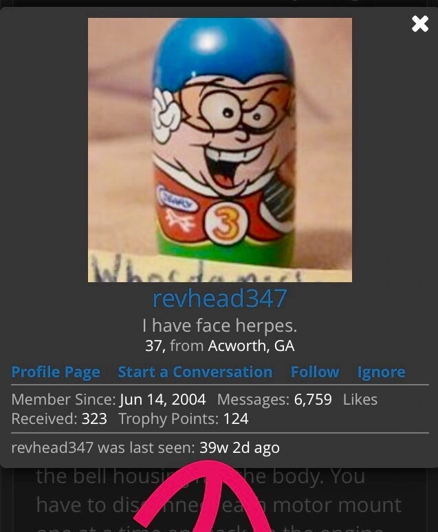

from6to8 said:
Called BBK the other day and if they used to I guess they no longer make a 1 3/4 for the SN95. I emailed you earlier too by the way
I've noticed you are bumping a lot of old threads-here is a useful piece of info when asking old thread participants .if you click on there name-it will (usually) tell you the last time they where on Stangnet
Hope this info helps.
