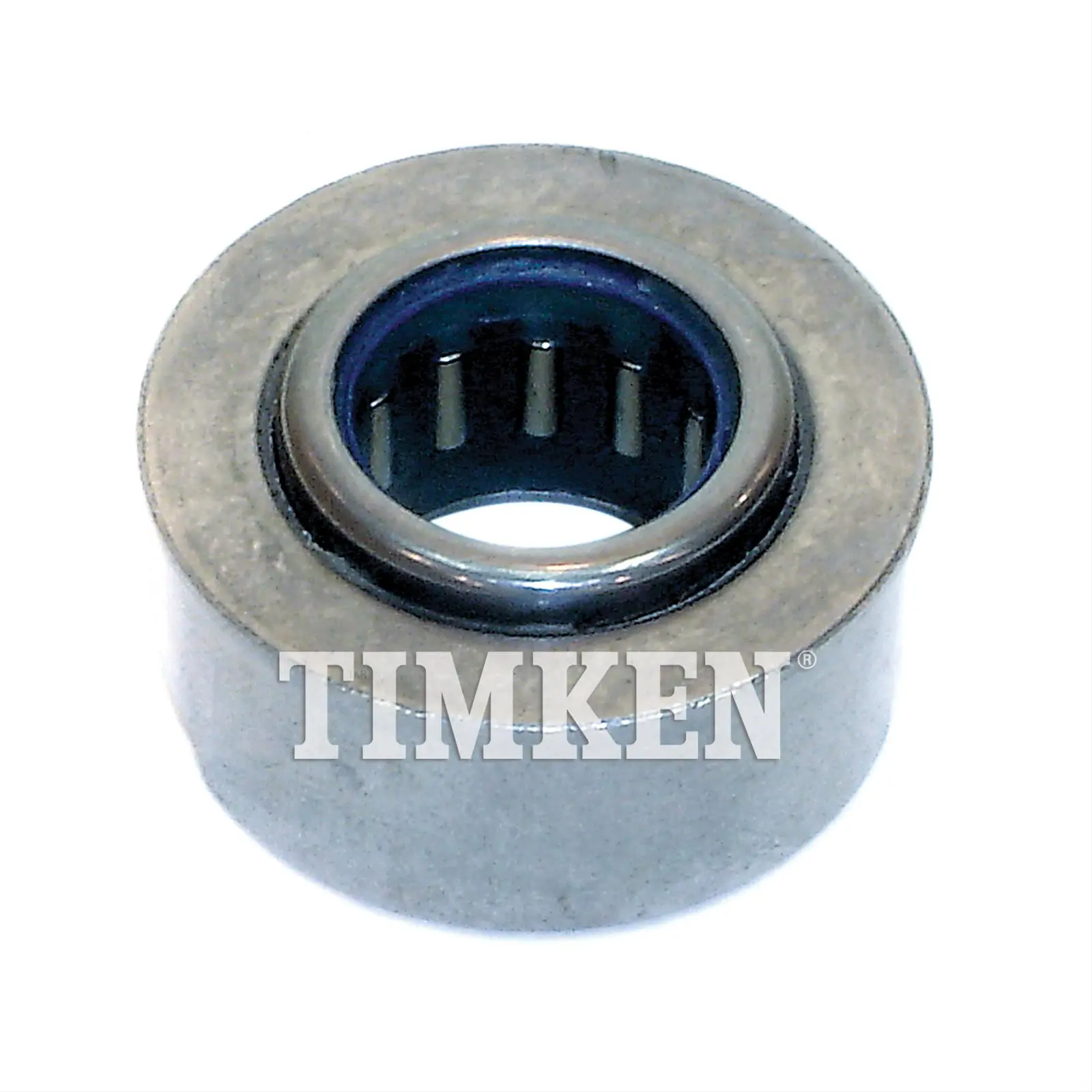

Ford pilot bearings have a lip on the end of the bearing that seats against the crankshaft flange. That lip determines how deep the bearing seats in the crankshaft. As long as the backside of the lip is seated against the crankshaft, you are good to go.
See https://www.summitracing.com/parts/tmk-fc65174/overview/make/ford for more information
