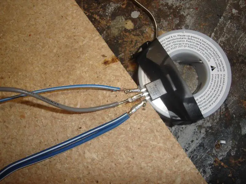

You need a voltage regulator. The Pioneer puts out 12 volts to the amps, but the Shaker 1000 only needs 5 volts..

Here is the voltage regulator installed:
Single blue wire is FROM the head unit, gray is ground, and the two dark blue wires go out to the factory amps (via harness that connects to factory harness).

I would still make a safe bet that the Shaker 1000 and Mach 1000 are similar in terms of the voltage they require to turn-on.
I was only making a suggestion.. It sounds to me like the exact problem one would experience when not using the voltage regulator.
