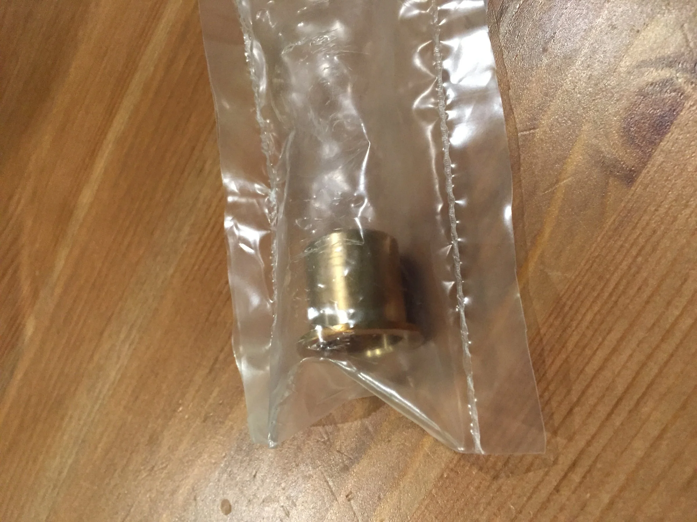

I picked one up. Next time I dig into the trans I'll swap it out and see if I notice anything

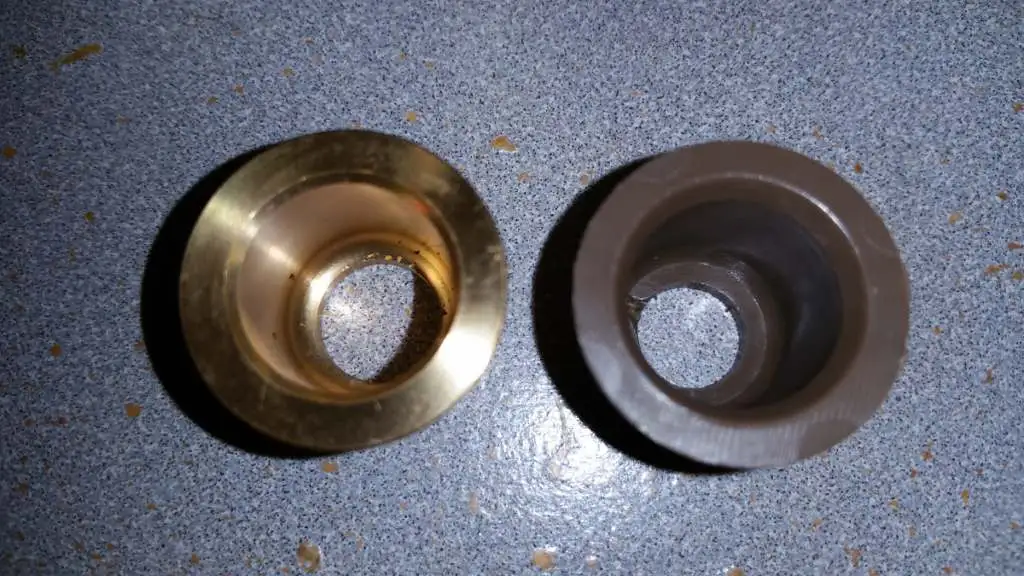

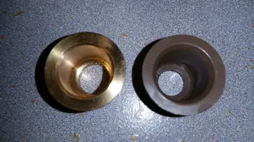

I have both types and tried them on the ball of my new MGW shifter. They are about the same size in my unscientific rattle test.. I see no reason installing the bronze bushing with some high pressure Redline synthetic grease wouldn't be the way to go.
