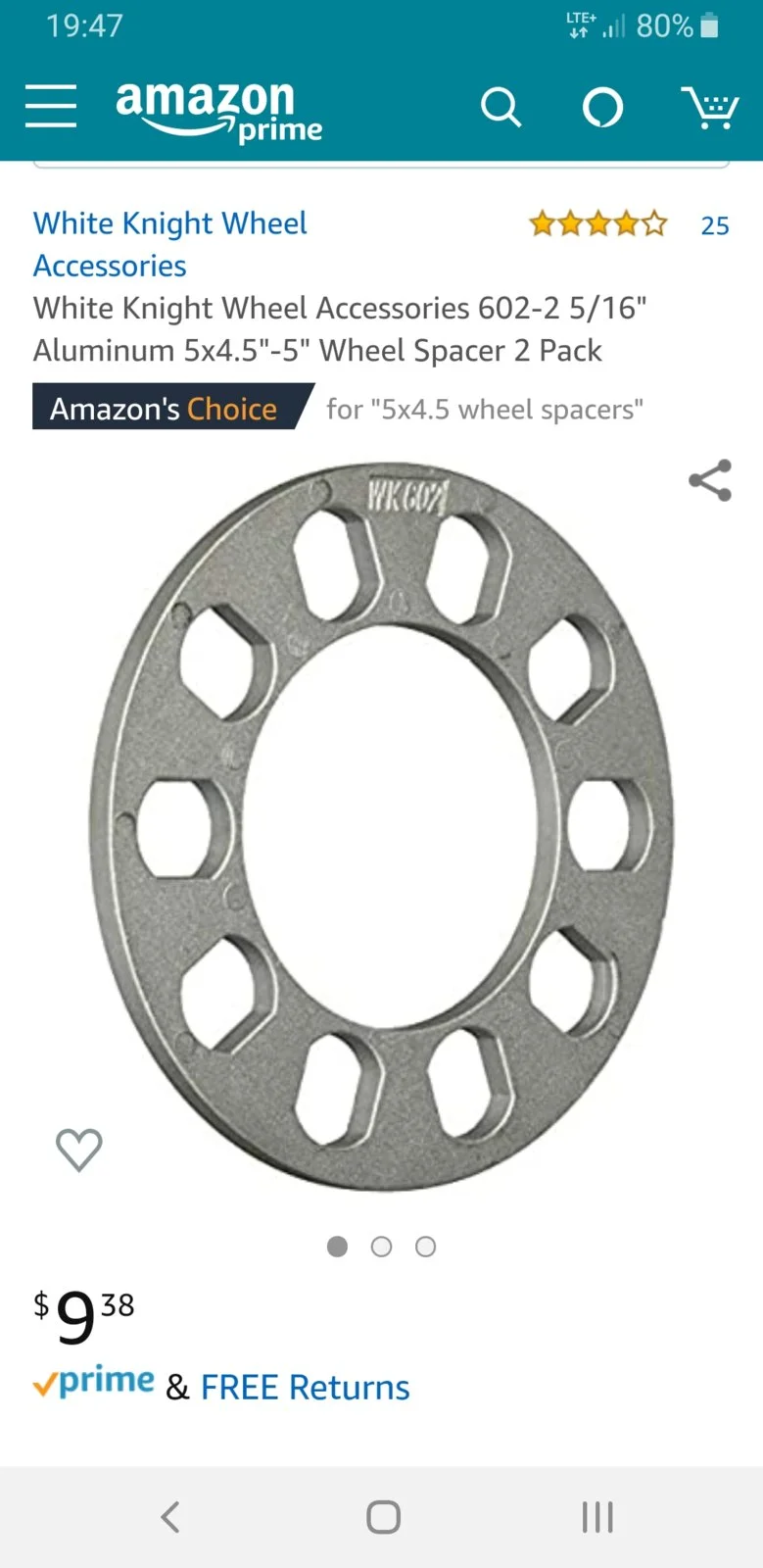

I have Fox length axles with 94-04 flanges and LMR 17X9 Pony wheels. I added a single 5/16" spacer to bring out the rear width.
